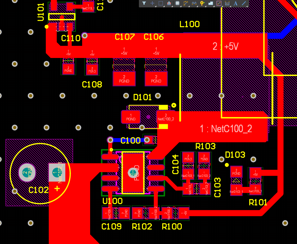

I layout to schematic datascheet
The problem is that when the load is used, the voltage drops. Imax < 20mA
You give me prize pphaps to overcome. Thanks !

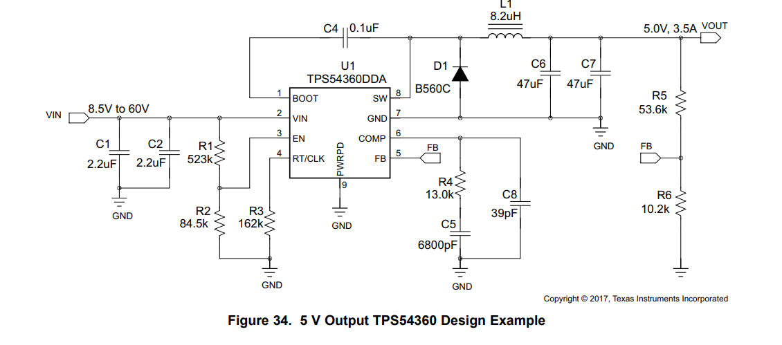

Hi Dong,
Please complete the TPS54360 design tool http://www.ti.com/product/TPS54360/toolssoftware#softTools to check that the component selection meets your design targets. Also, verify the saturation current of the inductor is greater than the current limit threshold of the TPS54360 (6.25A is the max spec).
If you still have an issue, you can send the design tool file and the PCB layout for review.
Tim
Try connecting a ceramic cap from the VIN pin of the IC to the anode of D101. Also, it's better to use a > 6A rated inductor.
Hi Dong,
Increase output current or increase inductance to exit Eco mode.
Tim

Currently with 9V 3A power supply, output 5V 0.86A
With 12V 3A give out 5V 1.3A
With 30V 3A, give 5V 2.7A
If my expectation is for 9V 3A, then I can output 5V 3A? In theory, this is possible. Is my power supply problematic

Hi Dong,
I recommend changing to a 6A inductor to ensure that saturation does not occur. Try to match the design example in the datasheet (5V/3.5A) as closely as possible.

Dear TIM
It seems like my problem has been solved.
Now we can align this topic.
