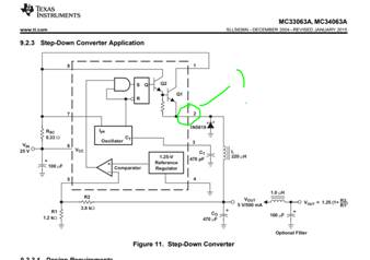

Hi team,
My customer designing a buck converter on MC33063A. Schematic i like this:
But the customer foun strange bevaior: IC usually have freqency about 73kHz, but at short circuit event, the frequency rises up to 147kHz.
Can you please explay why this happens?
There are scopes before a short circuit and during the short circuit.
Blue - voltage on Ct.
Yellow - voltage on pin 2.
    at normal operating condition, the Ton is approximately 6 time of the Toff. the charging current of the Ct is 1/6 of the discharge current.
    in the short condition, the charging current increases to reduce the Ton, but the discharge current is unchanged. i think this is why the frequency increase.
