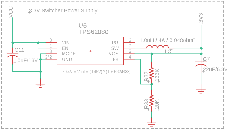

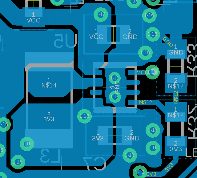

TPS62080: Need help verifying TPS62080DSGT design for 3.4V output
Part Number: TPS62080
We want to use the TPS62080DSGT to output 3.4V (really want 3.3V but decided to give some wiggle room in case load results in voltage drop).
Production is planned soon for this design and we want to make sure out schematic and component selection are valid for 3.4V...
Can we get support from TI on this? Any help is appreciated.
See schematic / layout below.
Component Part Numbers:
L3:       DFE201612E-1R0M=P2
C11:    GRM188R61C106KAALD
C7:      GRM188R60J226MEA0D
R32:    ERA-3AEB1333V
R33:    ERA-3AEB203V
