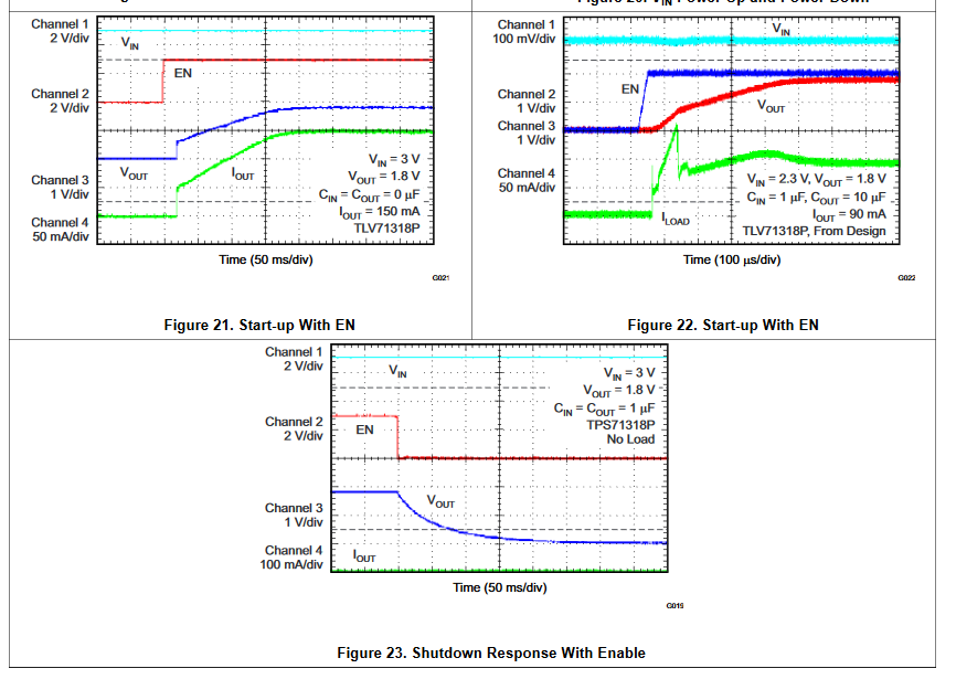

I have questions about TLV713P startup and shutdown. I found in datasheet these plots:
Do I understood correctly that startup without output capacitor is much longer (about 200 milliseconds) than with 1uF output capacitor(about 400-500 microseconds)?
How startup time depends form output capacitance? How to achieve the shortest startup time (Iout about 1-2mA)?
 From my understanding discharge process (for 1uF capasitor and 120Ohm resistor) should be finished in tens of microsecond, on plot this is tens of millisecond. Can you check shutdown plot?
