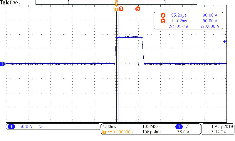

I have 89A set in electronic load.
Scope is reading up to 92A.
Spec: 89A/427µs (+400µs/-100µs tol.) I am measuring more than 1 ms.
  • Am I reading the waveform correctly? Please refer picture.
My protections are as follows.
Please let me know how to control ASCD discharge timing by modifying the above values.
