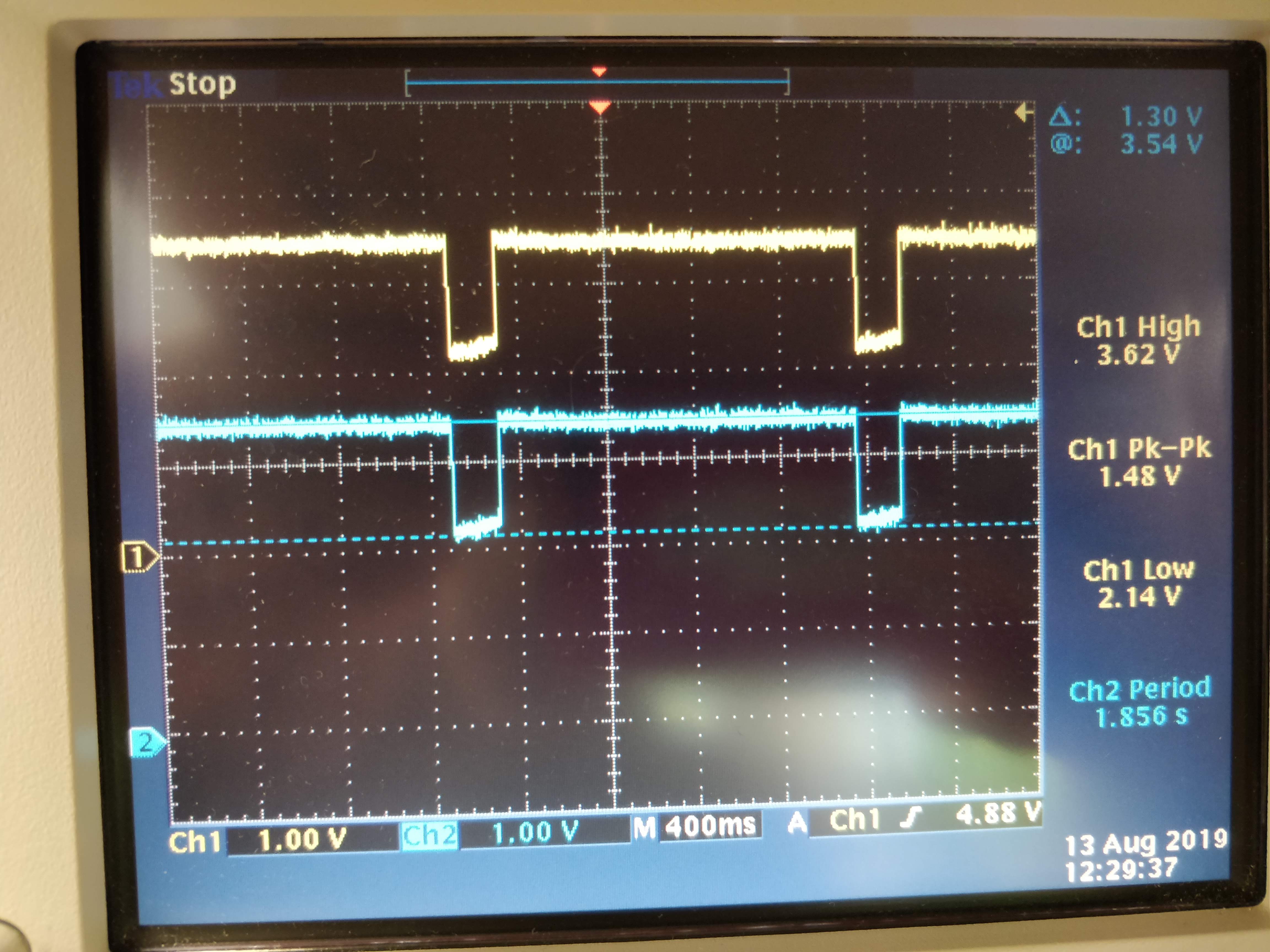

My design with BQ25713 encounters an issue. When there is only battery attached to the system and no register is set, I measured a voltage at HIDRV1 and HIDRV2 with behavior as shown in Figure 1.
With no DC input connected, the same voltage is transferred to Vbus which caused the charge status reg to show Adapter Present.
If I uncheck the EN_LWPWR, disabling the low power mode, HIDRV1 and HIDRV2's behavior change to as shown in Figure 2 and Figure 3.
  Figure 1 HIDRV1 and HIDRV2 with only battery attached
        Figure 2 and 3, HIDRV1 and HIDRV2 reset period change from 3.58s to 5.24s for different PCBs.
If I enable HIZ mode, the voltage on HIDRV and Vbus stays around 3.5V.
Comparing to EVM, HIDRV and VBUS should be zero when there is no DC input.

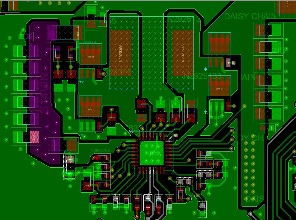

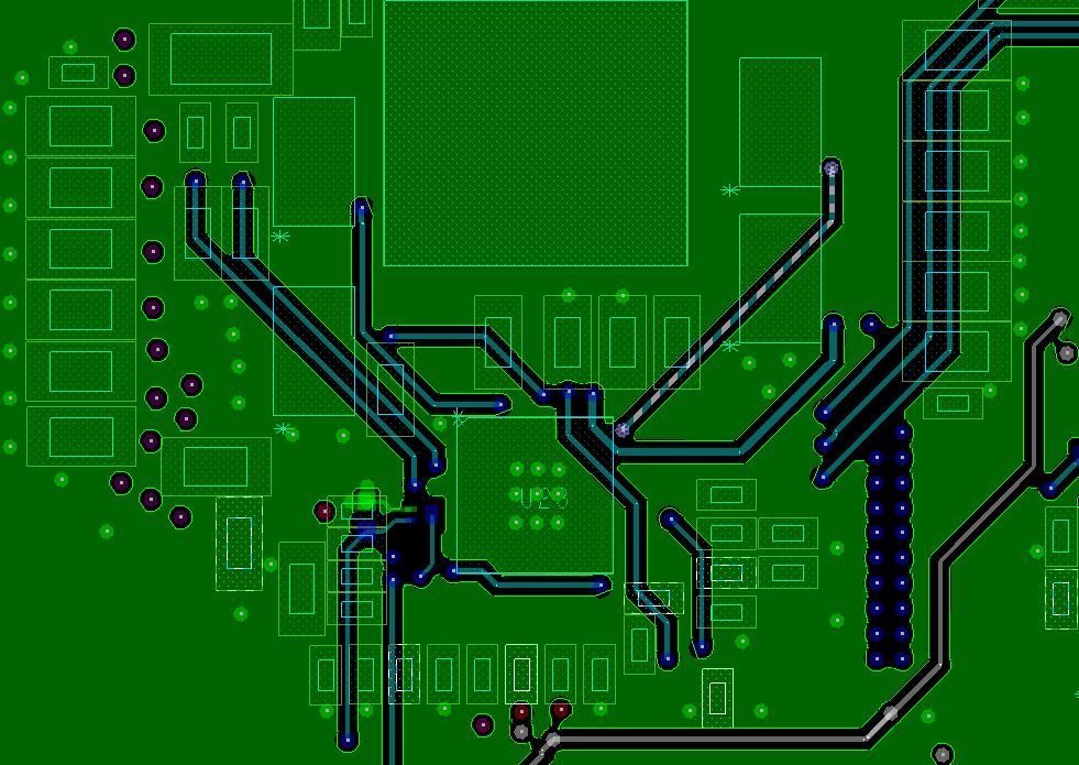

I also attached the screen capture of my schematic and layout.
Please feel free to ask if you spot any error or need more information.

  • Hi Jerry:
         The Vbus voltage looks weird with so obvious ripple. You can check your measurement setup to make sure it is grounded properly.
         For Figure 7, what is the CH2 signal? it looks much different with Fig6.
         What is the work mode of this test? I need to exactly steps how do you come to this waveform from your hardware startup. These will be helpful.
         Note please include switch node information for all the future waveform measurement. HIDRV1 should come with SW1 and HIDRV2 should come with SW2.

  • Hi Shishuo,
    SW1 looks the same as HIDRV1 in this case, and I connected VBUS and SW1 with a 1 ohm resistor in the schematic. This follows the EVM as JP7 is connected with P1 and P2. So as SW1 toggling, Vbus follows. I confirm that the grounding of my measurement is correct.
    For figure 7, CH2 is VBAT. It stays at 10.3V with no affect on HIDRV2.
    The device should be in boost and buck mode as power on. I have not set any register yet. I connected the battery and start reading the registers with EV2400.
    This behavior, HIDRV2 and SW2 not zero,  is not observed from EVM.
    I wonder if there is any mistake I made in the schematic creates this issue.
    Best regard
    Jerry

  • Hi Shishuo,
    Please note on my schematic that the 1 ohm resistor is connecting between DC input and VBUS, not between VBUS and SW1. There will be be power to the charger once I remove it.
    To follow the EVM schematic strictly, I tried to remove the 1 ohm resistor, then directly connect VBUS to buck boost input terminal (drain of Q1 ).
    But It dose not seem to do anything to the situation.

  • Hi Shishuo,
    The updated waveforms have been attached.
    Ch1 yellow is BTST1, CH2 blue is Vin, CH3 purple is SW1, CH4 green is HIDRV1.
    there is no different behavior observed between zero load and 2A load.
    And the frequency of the event, shown in the BTST zoom out, is the same for zero load and 2A load.
    Best regard

  • Hi Jerry:
         From the waveform, it looks like your HIDRV1 is just any offset 1V offset adding over the SW1 which means that you HIDRV1 is not driving normally. Do you try to replace a new part to see if this issue consistent? You may also need to replace the FETs also.
    Regard
    Shishuo
  • Hi Shishuo,
    Sorry for the confusion on the photo i provided. There is no offset between SW1(purple) and HIDRV1(green) if you look at the CH3 high and CH4 high on the right side.
    I offset the display so I can show you both of the waveforms.

    So far, I had
    1. replace the IC but the issue persists,
    2. compared the schematic and layout of both functioning and malfunctioning version of PCB,
    3. probe the resistance on both versions of PCBA and bare PCB respectively but found no short, open or big discrepancy
    Do you think if there one or more peripheral capacitors/resistor with wrong value would cause this issue?
