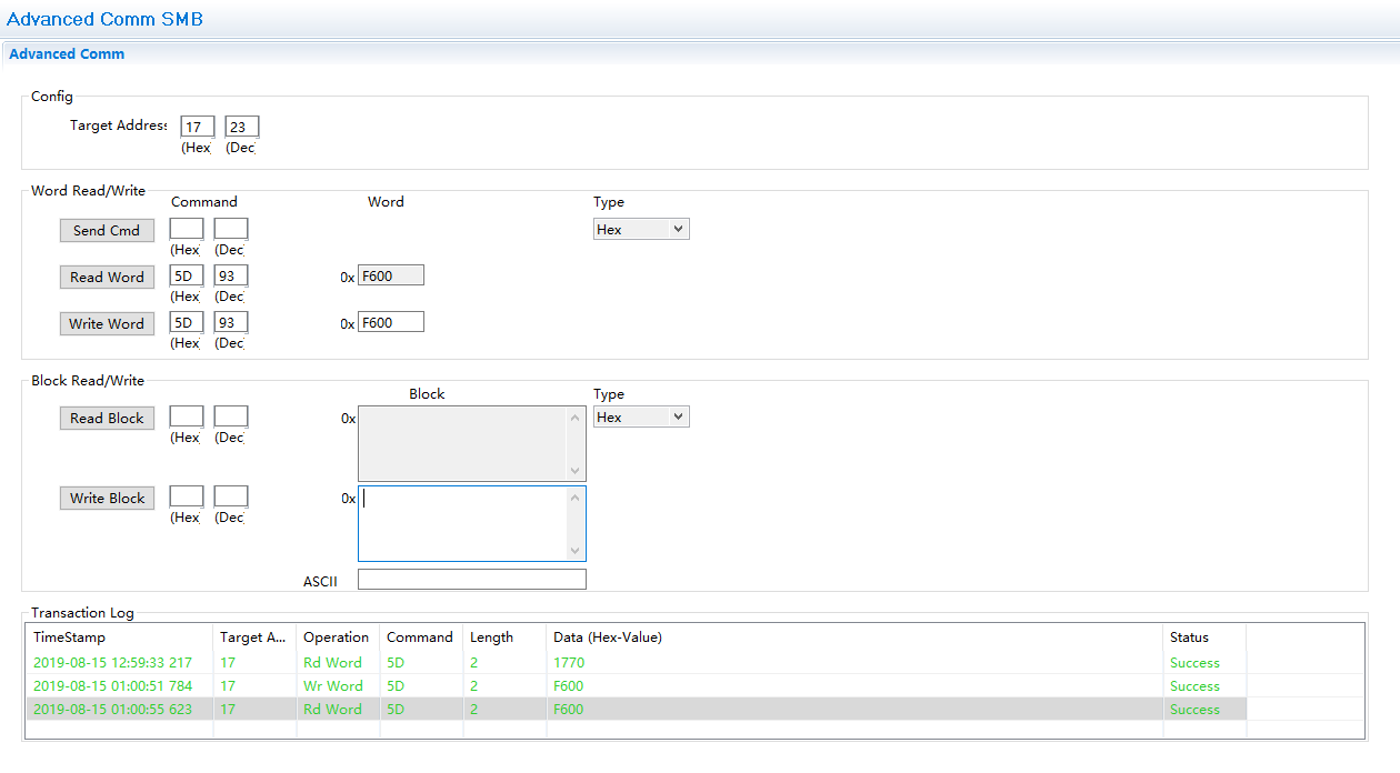

Hi

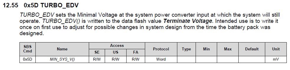

My customer feedback that bq40z50-r1 Term Voltage change from 6000mV to -2560mV after 3 cycles learning(the packs are sealed)
The failure rate is 38%. They also do some experiments to change the term voltage data during seal mode.
In seal mode, Advance Comm SMB of BQstudio is used to read and write DF register. They found that it is completely feasible to read and write. Moreover, it can be normally modified when they write negative Numbers into the Term Voltage.
BQ40Z50-R1EVM is unavailable in my side. Please help verify this.
