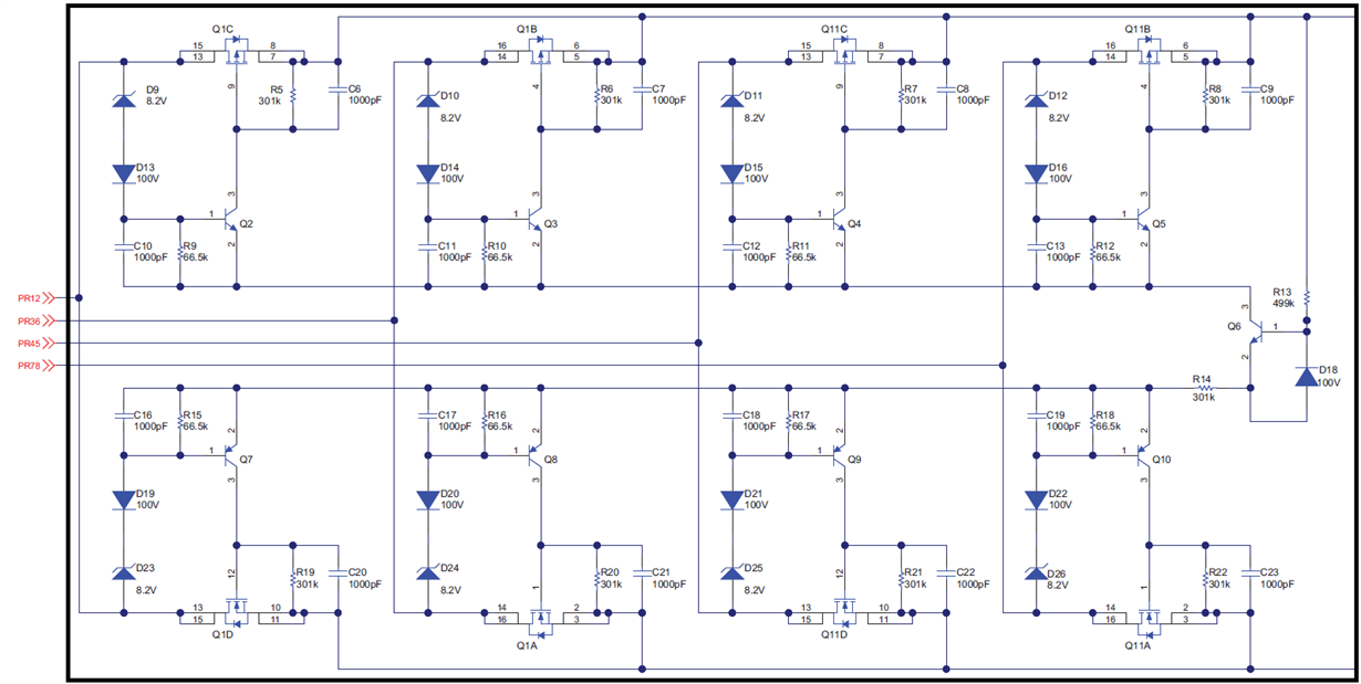

Hello
For layout view, could below components place to bottom layer under transformer(top layer)? Has any risk for it? Thank you.
BR
Patrick
Hello
BR
Patrick
Hello Patrick,
Thank you for your question! Yes you can move this section of the circuit under the transformer (assuming this is the data transformer). The two main considerations to be aware of are:
- do not break the transformer plane. Make sure there is enough space for the isolation barrier.
- have a clear bridge to the EMI filter from this Bob Smith plane.
Please let me know if you have any additional questions or if I can clarify anything for you!
