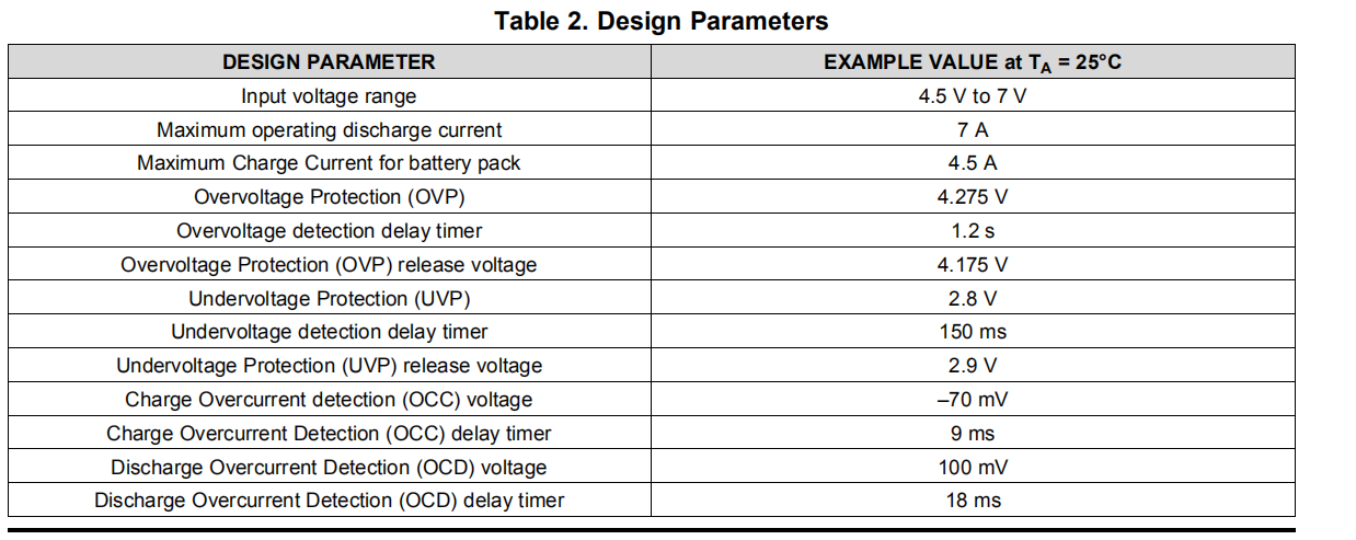

Since We plan to use BQ2973 as protection IC for 18650 Li-Ion battery module, which is made up of four 18650 Li-Ions in parallel.
First, is that ok to use this IC for our battery module? if not fit, is there any other recommendation?
Second, as below table, OVP is 4.275V, if we plan to change OVP from 4.275V to 4.15V, how can we get it?
