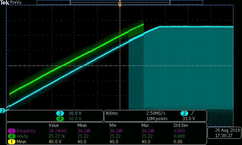

    Same situation with the second board. Please find a screenshot attached. Blue is the boost switching node and green the gate. It's startup, the SS pin is controlled with an external DAC and rising slowly. As the system enters Buck/Boost Mode, (input~output) both MOSFETs are switching but in "only boost mode", the high side MOSFET didn't switch. Any idea? What will stop the high-side MOSFET in boost mode? I can’t find this information (as well as the information related the internal charge pump) in the current datasheet.
  • Why do you use an external circuit to control the SS?  Can you just leave the SS pin with the CSS alone and see if the boost high side FET can switching?  I am afraid your control of SS makes the circuit think the soft start is not completed, so the boost high side FET is kept off to prevent back flow current, which is to cope with the case of starting up with output pre- bias condition.
    Let me know the results.
    Youhao
  • I use an external circuit at SS pin to control the charge current to the battery. That's a recommendation (or idea) from TIs side.
    ...but you are right, without the circuit, the MOSFET is switching as expected. Thank you, great idea and support!
    What can I do? Is there a voltage level at SS pin softstart is disabled? Do you see another/better option to control the charge current?
  • Thank you Horst for confirming the SS issue.  The idea of using SS directly to control the SS is not a perfect one, if it came from my colleague.  It might be a misunderstanding about the LM5176's average current limit, which actually pulls down SS.  However, it is different than your externally pull-down because the IC cannot distinguish it from the SS incomplete state.  When the internal pull-down of SS occurs, the IC knows it is in current limit mode.
