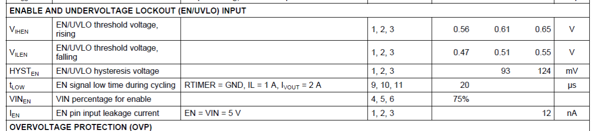

Team can you help confirm the below:
What does the second from the bottom row mean – VINEN? The 75%? Does it mean that if I am switching 5V. 75% of 5V is 3.75V, do I need a signal which is at least 3.75V?

Hey Michael,
The 75% specification is meant to say "Do not enable this part before VIN gets to 75 % of its final value to ensure a nice clean startup"
