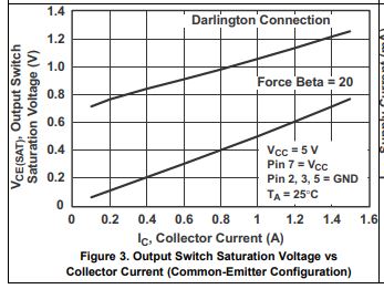

5.for fig3, does it mean that those 2 curve on graph show maximum Vce and Minimum ?
