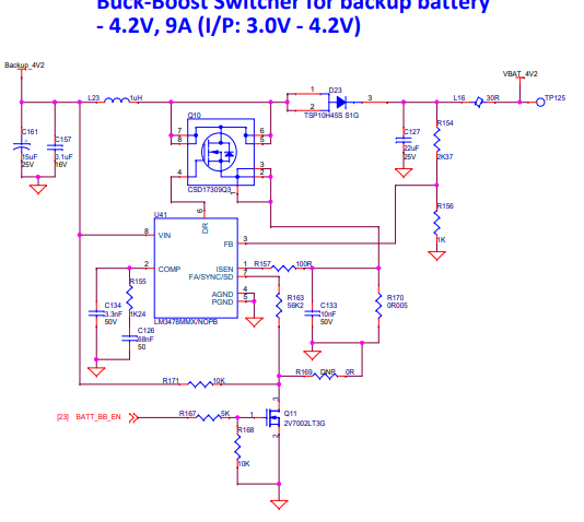

We are using LM3478 in one of our project with below configurations:
Vin: 3.0V to 4.1V
Vout: 4.2V
Iout: 8A
Below is the schematic that is designed based on the suggestions provided on webench:
Same has been taken from the webench design tool.
Few observations as below:
1. As soon as output current crosses 3.5A input capacitor C161 starts heating (>50-60 C)
2.  If raising load current >4A IC stops the switching and we receives VIN-0.3V in output.
3. Tried changing resistor value for R163 and change the operating frequency but no any change observed in results.

    Thank you for designing with the LM3478.  Please use a quality ceramic capacitor for C161.  Also, please use short cable to connect your power source and remember to twist the input and return cable.
    Changing R163 is not a solution here.  Anyway, you have an error in your schematic.  C133 should be placed across ISEN pin and AGND. Change it to 1nF.

    We tried modifying the capacitor as suggested and also applied few other changes as listed below:
    1. Changed input capacitor C161 to 47uF (previously 15uF).
    2. Changed C133 to 1nF and kept it across ISNS and GND pin (tried with / without 100R (R157) between Rsns (R170) and Isns pin.
    3. Added 47uF Electro. capacitor on the output side.
    4. Shorted input path for switcher IC.
    As a result was able to get the output of 4.2V upto 3.8A output current. As soon as we try to increase the current above this, the switcher IC stops working.

    Sorry for the delay owing to my business trip.  Could you monitor the ISEN pin voltage waveform?  Please how both overview (a few cycles) and a zoomed in (one or two cycles).

    We were able to achieve upto 4A successfully with the same design without any modification.
    Now we are trying to reach up to 9A (originally design for) and at the same time checking the efficiency and the other parameters also.
