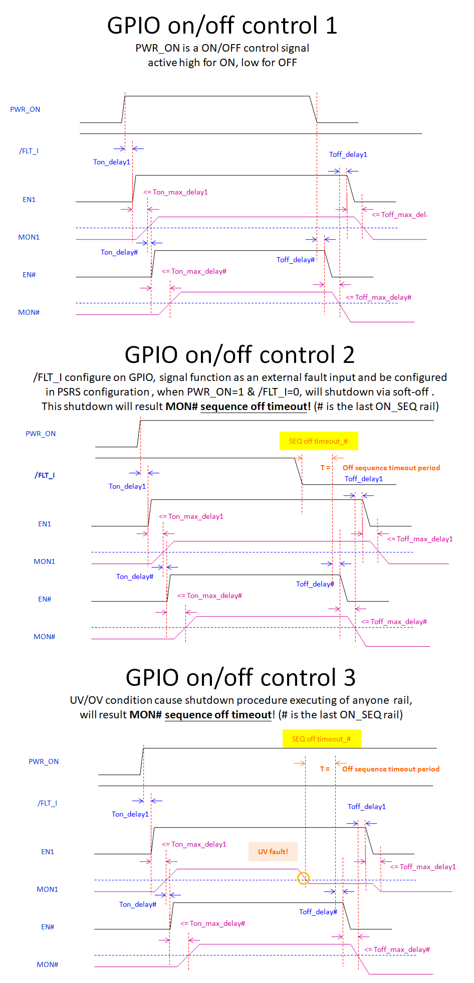

Q1: Why OFF sequence with warm?
I have configured 2 GPIO to control 10 rails power, one is "PWR_ON" ,active high for power on/off control, other is "/FLT_I", active low, it's function as external fault signal input to disable "PWR_ON" turn-on & shut down all rails when "/FLT_I" = 0;  3 type behavior be described following:
1."PWR_ON" behavior is correctly !
"PWR_ON" = 1 (with "/FLT_I"=1), all rails turn on following the on-sequence.
"PWR_ON" = 0 (with "/FLT_I"=1)  all rails turn off following the off-sequence.
2."/FLT_I" behavior result a warm message:<off sequence timeout> on rail #9 & rail #10 with correct off sequence.
I make sure the time is equal to rail #10's off sequence timeout period (time between "/FLT_I" falling to low and rail #10's enable de-asserted to low ).
3. UV/OV of any rail  fault (except rail #10) cause shut down behavior result a warm message:<off sequence timeout> on rail #9 & rail #10 with correct off sequence.
I make sure the time is equal to rail #10's off sequence timeout period (time between "MON #" voltage below the power good off and rail #10's enable de-asserted to low ).
I expect the  shut down procedure is a correct off sequence without any warm , but type 2 & 3 still get off sequence timeout !

    #1. Q1: Why OFF sequence with warm?
    Please check section 4.2 of http://www.ti.com/lit/an/slua815b/slua815b.pdf to understand how dependencies are met.
    For GPI, they are considered to meet the sequence off dependencies only if they are de-asserted. I do not think this is the case in your system,
    Why do you want to have the turn off dependencies on the GPIO1 and GPIO2 for Rail 9 and 10. These two signals are used to turn on and off rails. there is no meaning to set as turn off dependencies.

  • Thanks for your reply,
    When I configure FLT_I to a active high signal ( without GPI fault enable behavior), On the PSRS configuration I set as following:
    FLT_I             PWR_ON      state  enable    Turn off mode Rail#1 ~Rail#10    : My expect function
    De-asserted  De-asserted      0/4      Uncheck                                                    : Power off status & external fault active
    De-asserted  Asserted           1/5      Check      soft off          whole off               : External fault active so by-pass power on function
    Asserted       De-asserted      2/6      Check      soft off          whole off               : External fault inactive, normal power off function.
    Asserted       Asserted           3/7       Check      soft off          whole on               : External fault inactive, normal power on function.
    "When FLT_I is low , your PWR_ON signal is still at HIGH which is considered as ASSERTED. that's why you get the sequence off warning."
    Your meaning is FLT_I is de-asserted & PWR_ON is asserted right ? but I set this input condition will do soft-off function !

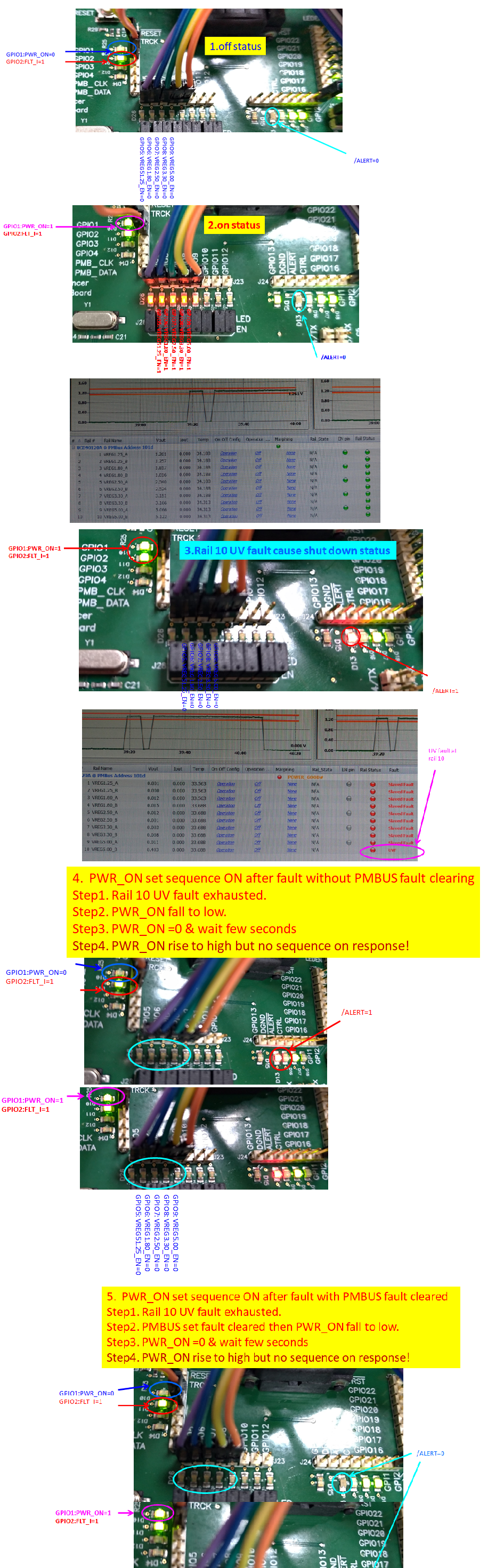

  • Yes, When a UV fault detected ,my PWR_ON & FLT_I was kept high both, I follow your recommendation to switch PWR_ON to low then set to high again, but no sequence on response!
    Following is my EVB status picture, may I miss any key point ?
    Thanks for your assistance!
    Regards.
    Jack Lin
  • Hello
    I was able to duplicate the issue and confirm that this a bug when PIN SELECTED RAIL STATUS is used to re-sequencing the faulted rails.
    There is another way to do so. after rails are shutdown due to a fault, you can enable the re-sequencing feature inside the fault response to re-sequencing the rail without using PWR_ON and FLT_L signal.
    you can set the how many re-sequencing to try and the interval between each re-sequencing.
    once the re-sequencing count is expired, the device will not start the resequencing again until the device is reset or power up.
    Will this work for you?
