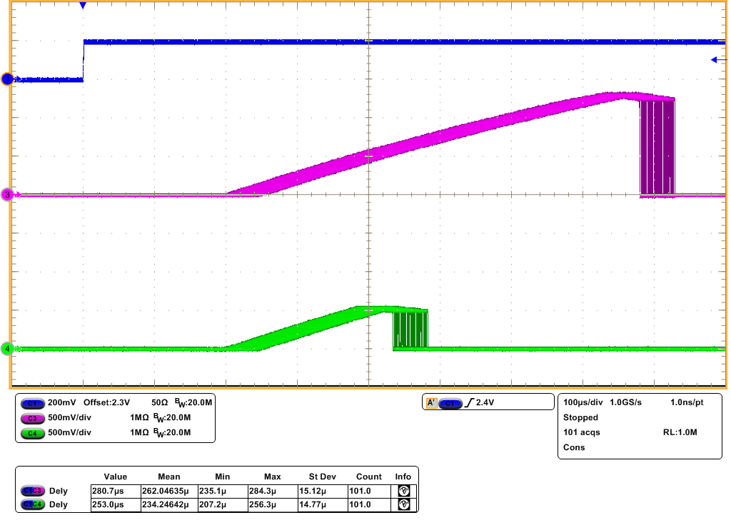

Regarding CWD and CRST pin evaluation time,
CH1:SENSE, CH3:CRST, CH4:CWD
it is 381us after SENSE enters valid window?

Hi James,
The 381us time on the datasheet is the minimum time required to recognize the capacitor value connected to the pin and charge it. This is after SENSE is valid.
