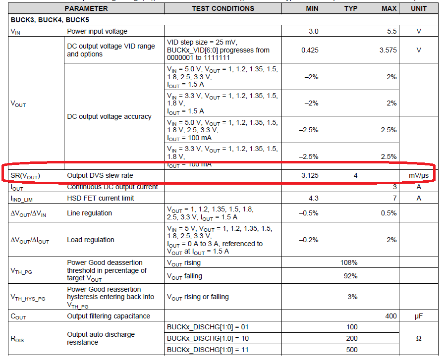

       May we adjust the power on slew rate of BUCK3 ~ BUCK5 ?
       For the estimation of rising time during powering on, can we just use the expected voltage divided by the slew rate 4mV/us ?

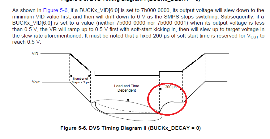

      As to another question is about the soft-start. May we set the buck 3 ~ buck 5 to enable the soft-start during power on?
      It's some like what datasheet depict the DVS as below

  • Hi Edward,
    This Slew Rate you highlighted in the data sheet is the slew rate when using Dynamic Voltage Scaling, not on startup. The start up slew rate is not fixed, but is dependent on the inductor and output capacitors selected for BUCK3/4/5. This statement is incorrect, refer to my next answer for the correction.

          As to the soft start mode set by default during power-on, does that means the ramping up time will be at least more than 200us?
          My customer gave the ramping up time measured on their side, the period in each rail is less than 200us.
          Is there possible our customer disable the soft-start function?

  • Hi Edward,
    Soft start on TPS650861 is always enabled and cannot be disabled. I misspoke before when mentioning output capacitance and inductance, the ramp up time is tied to VREF. As VREF ramps up from 0 to 0.4V, output voltage also ramps to the target output voltage. This timing is set and not changeable. Unfortunately I do not have an exact number for how long this ramp up is.
    As a reminder, we recommend using a maximum of 400uF output capacitance and 470nH inductance.
