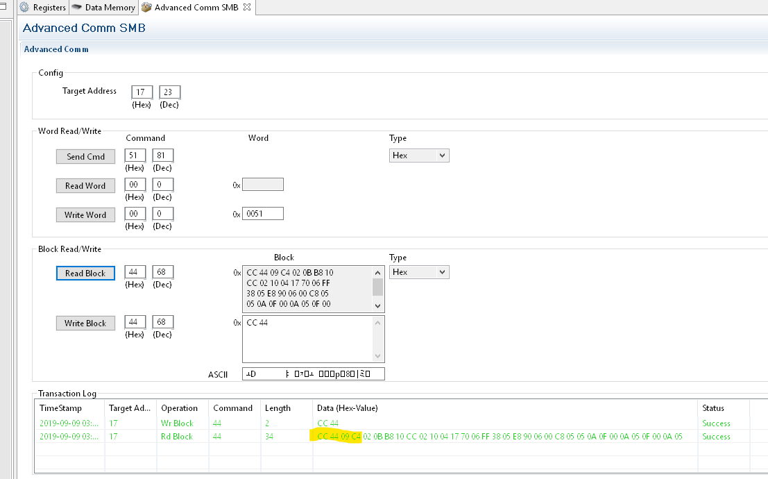

I'm having problems communicating with the fuel gauge...the problem is as follows:
First, I can send the reset command with no apparent complaint - it properly ACK's the I2C transaction.
BUT, when trying to do a block read from the DF, I first send the command and address, but the 350 does not ACK the last byte. Then, if I ignore this and send the repeated start to do the read anyway, the 350 returns the LSB of the address, but then all zeros ??????????
I'm "guessing" this is a result of the NACK error, but I don't know.
Any help would be appreciated...

  • Hi Jeffrey,
    I gave this a quick try using BQStudio and the EVM and I am able to read this location okay. Here is the screen shot below from BQStudio. I will send you the scope shots by email, though they are a little hard to read due to resolution.
  • Hi Jeffrey,
    I am closing this thread since we've figured this out through email. I think you are correct that the documentation should be more clear and I will enhance this in the next revision of the TRM. As you pointed out, the TRM needs correcting in this section, since it says that the first bytes returned are the address bytes, but  the device returns a byte count first (SMBus spec), followed by the DF address and data.
