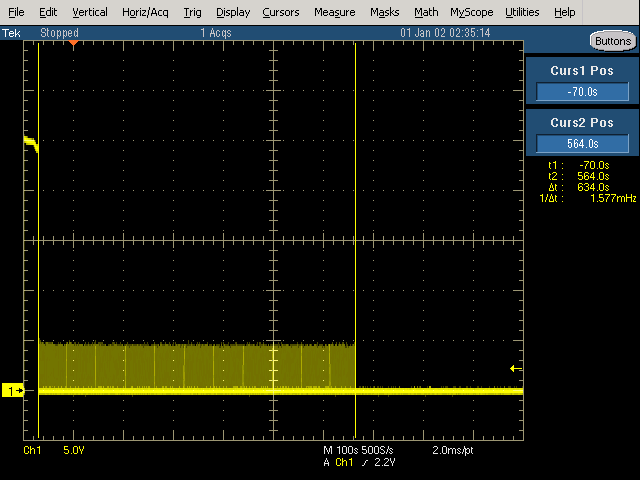

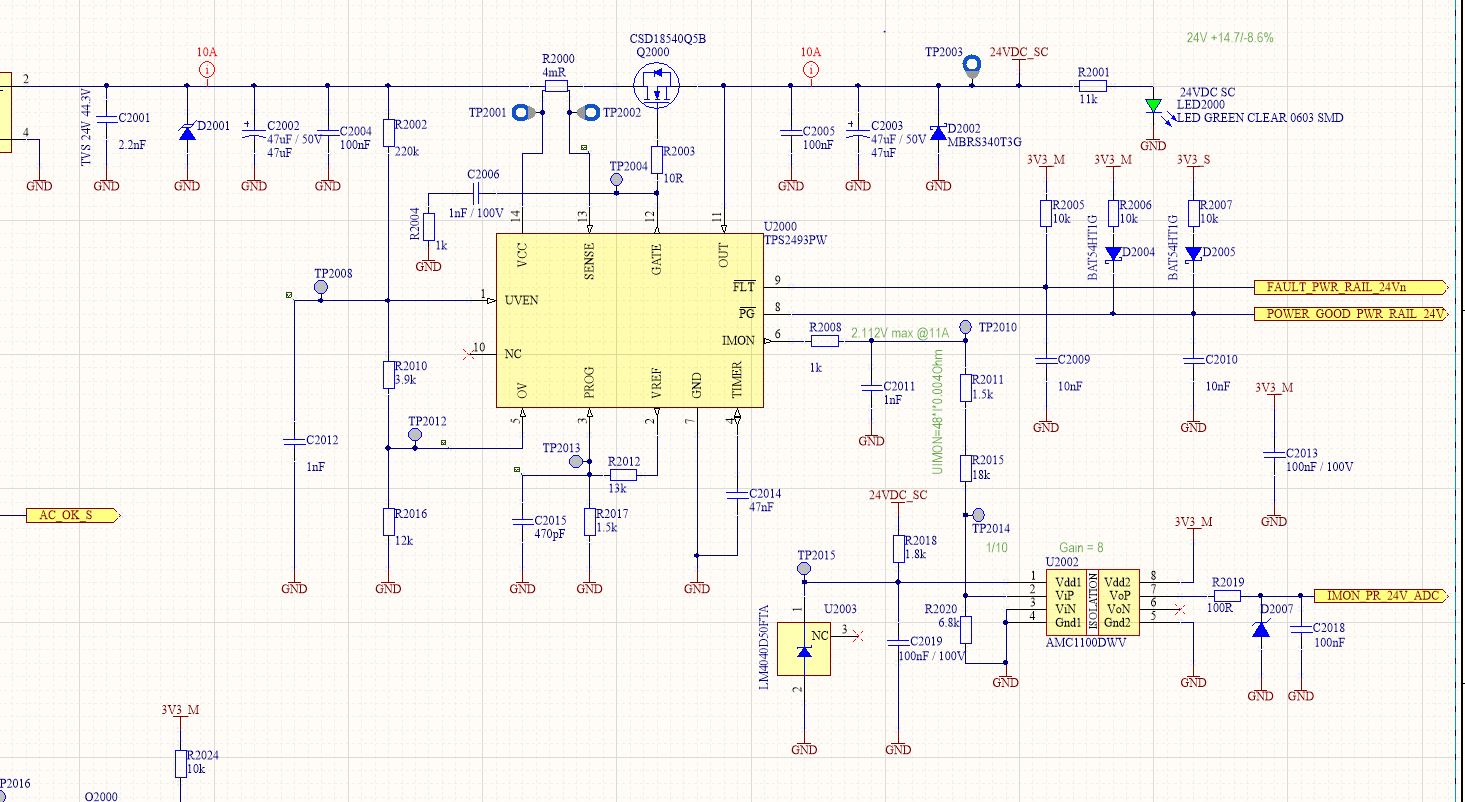

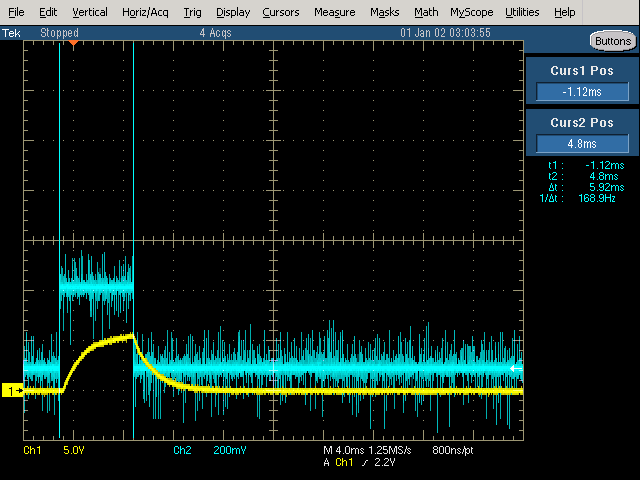

Hello
We are using the TPS2493PWR. During tests I observed the following behaviour. If the device switches off because of an overcurrent event occured, it tries to restart in time Intervals with gaps of TRETRY as described in the datasheet. How many times does it do that? I observed different number of retry cycles: e.g 13 times, 28 times, 41 times.. After that, the device shut down and could be restarted by eliminating the overcurrent source and performing a power cycle.
Best regards
