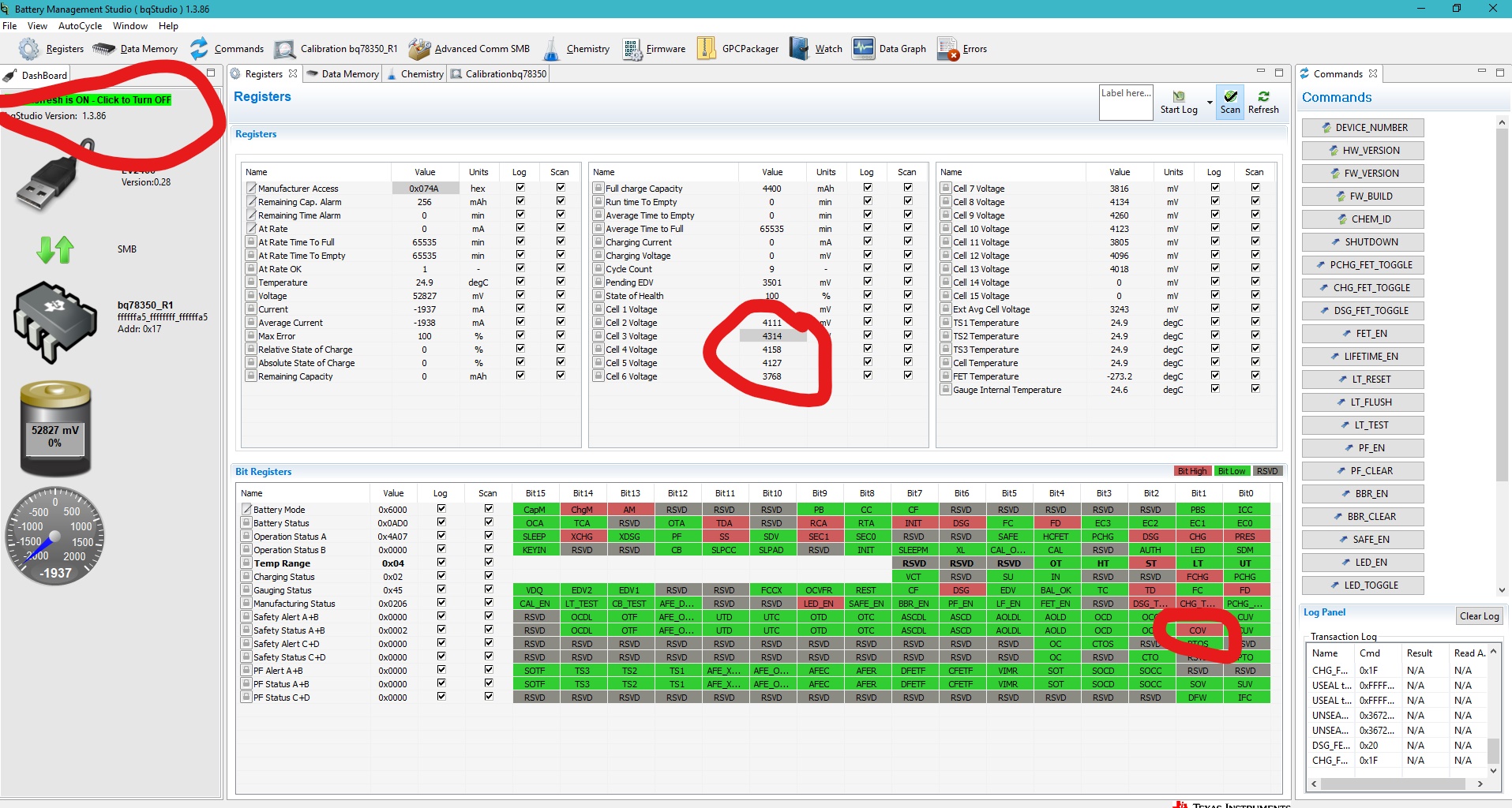

  • helo sir,
    1.even the auto refresh and scan is  ON ,the dashboard is not reading the values continously why?
    2.when we connected our pack to the board in the morning for first time then the voltage values are shown on the display correctly.it is in complete operation since morning now in the evening when the cell3 voltage is dropped to 2800mv it is still reading the value which is in the morning and it is creating COV fault and unable to perform any function rightnow.i think they must change according to the state of the cell but no change in those cell voltages.what could be the reason?
    3.another issue we are facing is that, when the device is in normal operation the FETs are turned ON and it is working good. but when we are charging the device,the CHG FET are turned OFF and DSG FETs remains ON. again when we remove the charging to the device both CHG and DSG FETs are ON. since the CHG FETs are turned OFF during charging ,will it allow charging or not? if this is wrong,then how the CHG FETs remains ON even during charging.(this issue is not shown in the image).
     for the 1st and 2nd issue,i m posting the image ,so that u can understand the problem easily.
  • Hi Pavani,
    1. I don't know, you will need to figure out why.    In the figure somthing is not right since the device number shows fff...  this should read 1e9b..., see the EVM user guide http://www.ti.com/lit/pdf/slvu925 figure 10.  Re-start BQStudio and see if it is correct.
    2. The data looks wrong.  If it is not showing actual cell voltages, you are not getting current data.
    3. Yes, the device has body diode protection.  If you have charged to a COV condition and the charge FET is off, the charge FET will turn on again with sufficient discharge current.   It takes the part time to recognize the current and respond with FET control.  Your system should prevent charge or discharge, if you connect both and they can cycle, you can trick the part into charging periodically as your discharge tricks the battery into turning on the body diode protection.
