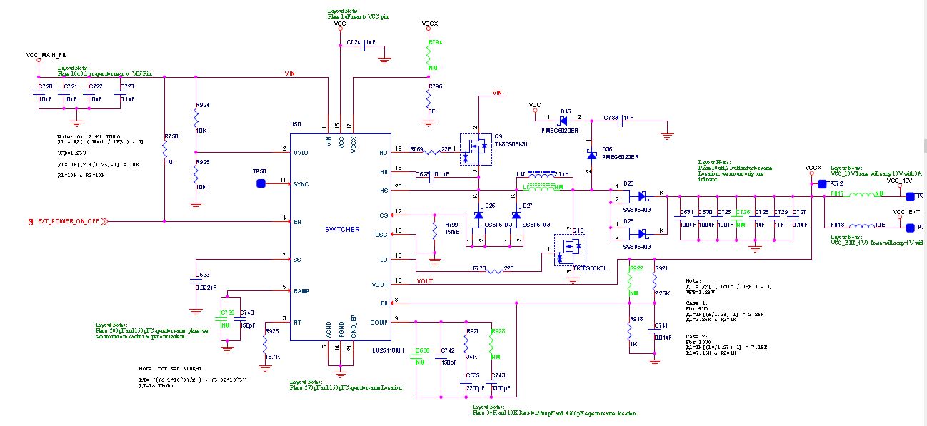

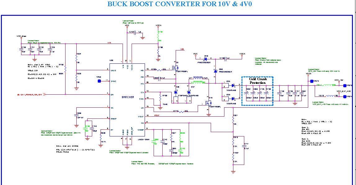

We are designing a power supply using LM25118 IC which have below requirements.
1) Input voltage: 9V to 36V(down to 3V at the cold crank)
2) output voltage: 4V@7A  and 12V@3A
3) what is the output voltage at our input voltage is 3V in cold crank condition?
