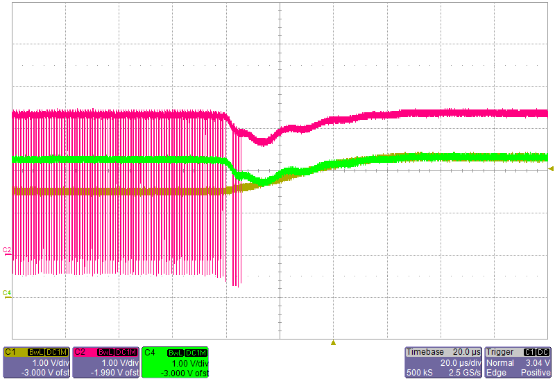

My customer is using the TPS54318 now for 3.3v Vin, 2.5v Vo. We want to check the Vo phenomenon(waveform) if the pull-down feedback resistor is short to gnd.
Could you please help provide it? Thanks.

    For any buck converter, when the FB pin is below the target voltage the IC will increase the duty cycle to try and bring FB up.  With FB grounded, the IC will operate near 100% mode and Vout will be nearly Vin.

  • Hi Frank,
    Here is the waveform, which shows the basic operation.  You may have more questions, so it is good that you ordered the EVM to test per your requirements.
    Yellow is 2.5Vout
    Green is 3.3Vin
    Red is PH
    Yes, they are welcome to keep using the older TPS54318.  This is ok.  But I ask: why is the customer working on a new design?  Why is their existing system (the previous design) not enough?  I think it is because they want to make some improvement in their design in order to make it better.  TI does this too in our ICs.  After many years, we have better ICs than we did before.  So, you should consider moving to a newer, better IC.

    Thanks  for your support. After short the low side resistor, the device will operate like your picture then keep stable, correct? Thanks.
  • Hi Frank,
    I don't know what you mean by 'stable' so this is another reason to measure the EVM and see how it behaves.  Then, you can judge the performance.  I am also traveling this week, so I cannot take any more lab data until later.
    This app note (figure 4) shows operation in 100% mode, where the boot cap needs to be recharged: http://www.ti.com/lit/an/slyt747/slyt747.pdf
