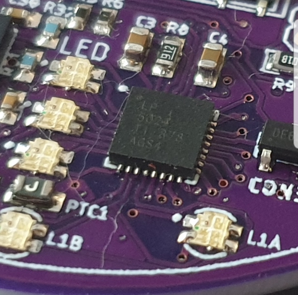

Incorporated a LP5024 on a design without doing proper investigation...
Find my LP5024 using the broadcast address and the address set (ADDR0 and ADDR1 pulled down to GND)
Im using 3v3 and measure 1.7v on the vcap.
LED's are common anode RGB from Inolux (IN-S66TATRGB)
Im driving them directly of USB so I measure about 5V on them...
This is the output from my attempt to get them lit up. Nothing happens

  • Hi again,
    Initial reported problem is resovled and LED's are tuning on when addresses indfividually. Next issue is that I cannot get the bank functionality to work.
    And one LED is less bright than the others using the same brightness setting.
    I have arranged LEDs so that 0-2 channel is connected to a single RGB led and the other 3-7 are assigned to 3 RGB leds ... Banking is done by assigning channel 3-7 sending 0xf8 to LED_CONFIG0 (0x02). Then setting bank brightness via address 0x03 to say 200 (should be 255 by default).... Setting BANK_A_COLOR to 255 ... Nothing happens..
    Also cannot figure out why LED0 is so much more dim than the other ones. Maybe try swapping out that LED for a new one?? The red LED in the "center" of the PCB.
  • Hi Fredrik,
    1) It should be OK to set bank control in your setting (0xF8 to register 0x02; 0xC8 to register 0x03; 0xFF to register 0x04) and I tried in EVM to confirm it successfully. Have you configured the Device_config0 (0x40 to register 0x00) to enable the device before setting bank? Also you can attach your code for us to debug.
    2) Can you measure the forward current of LEDs in your board? it is more effective to determine if the device have abnormal output.
    And do LEDs have common anode connection or red one powered by individual supply? Red LED have smaller forward voltage than green and blue. Normally it would be slightly lighter in the same current.
