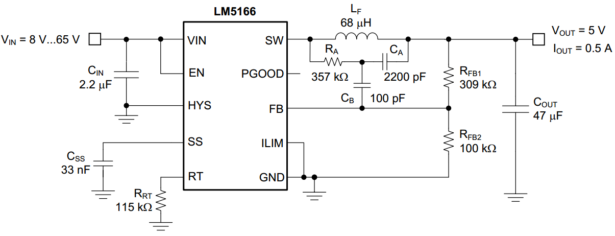

I have a BUCK design working in a light-loaded burst mode operation with audible noise.Some FAEs recommend the following circuits to reduce noise.
I don't understand why this works. Looking forward to your answer.

Hi Andy,
Thank you for your comments. Due to your patient guidance, I gradually understand the circuit principle. Its work at light loads does reduce the output voltage ripple. But I still have some confusion about this circuit working under heavy load.After all, its FB pin introduces the SW voltage signal. What is the performance of the circuit under heavy load conditions?
