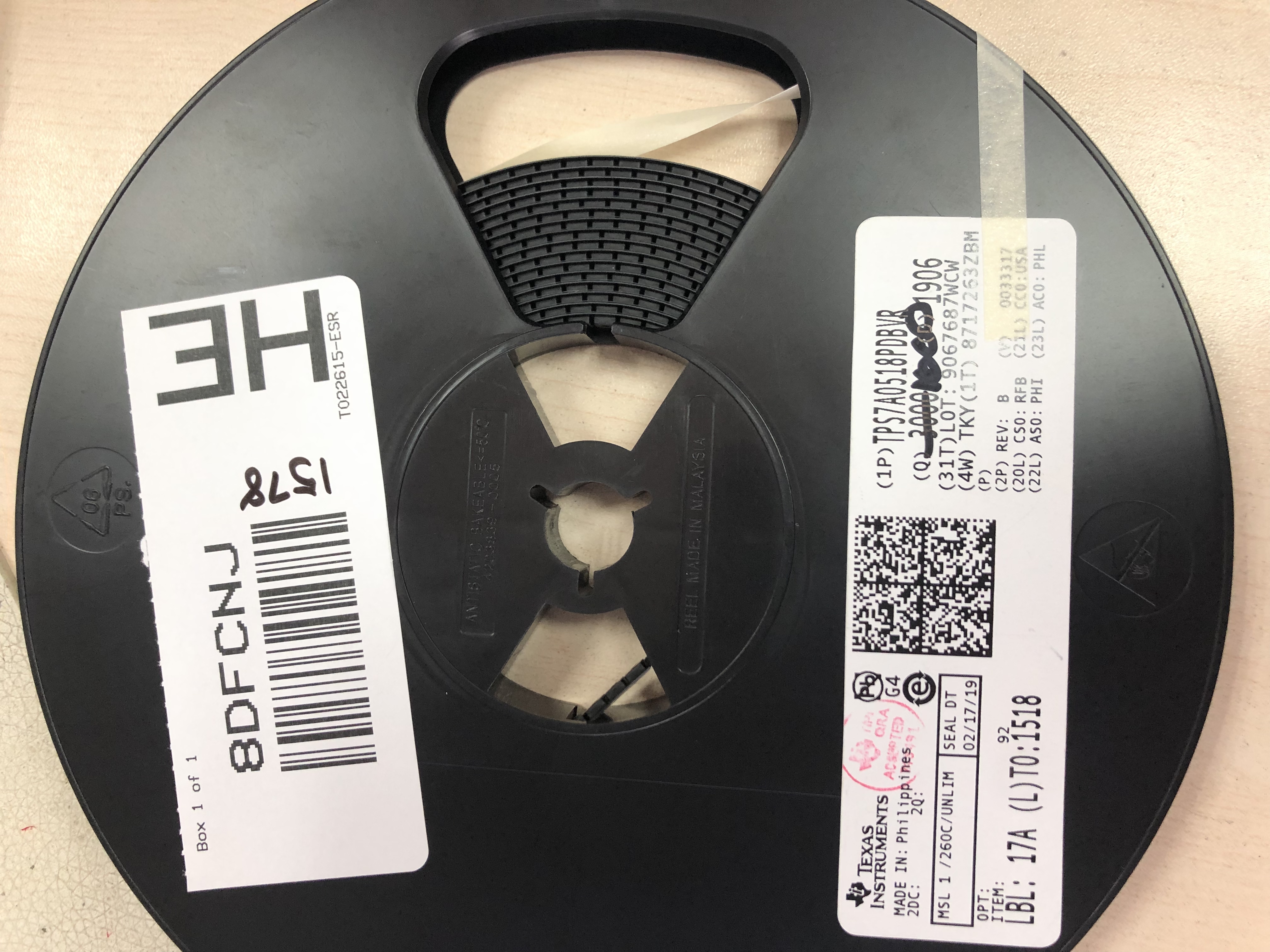

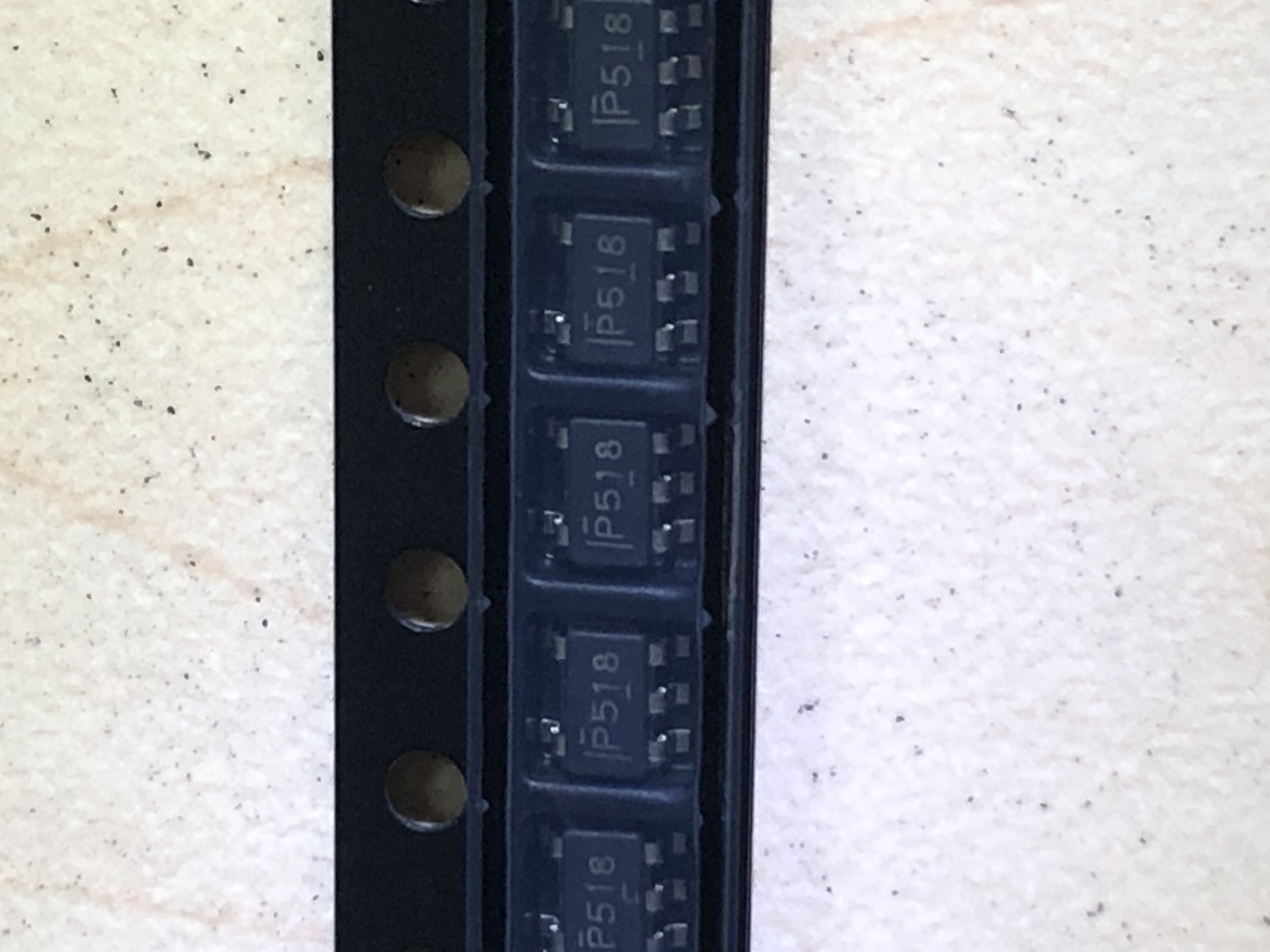

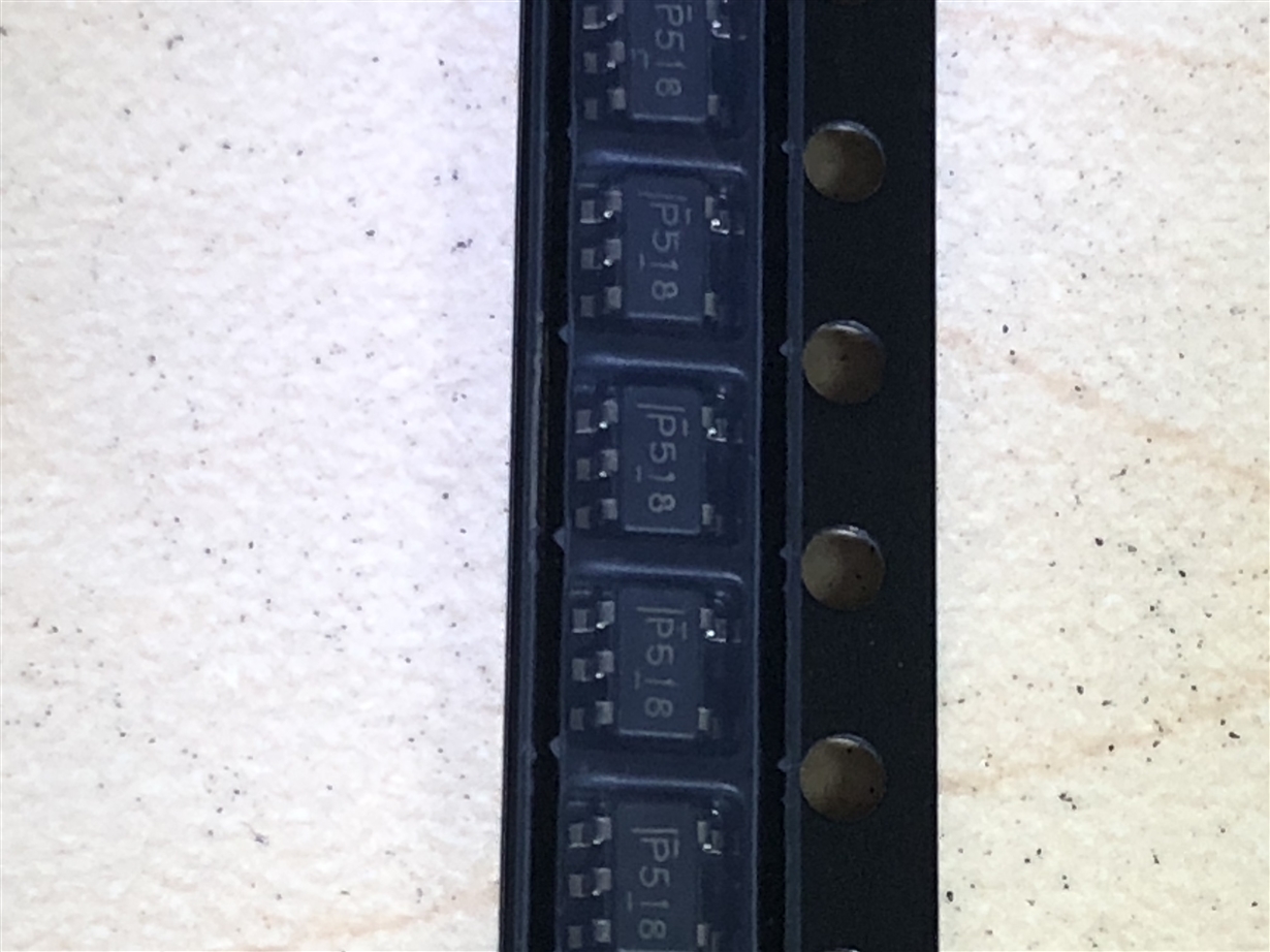

TPS7A05: TPS7A0518PDBVR TI Official Chip Screen Printing Display: 1INF; Actually received the Chip Screen Printing is: P518.
Part Number: TPS7A05
TPS7A0518PDBVR  We received the purchase from MOUSR yesterday.
TI Official Chip Screen Printing: 1INF; The actual received chip screen printing is:P518.
 Would you please help me to see if the received chip screen printing is correct?
Why is there a discrepancy between chip screen printing and printing on official website technical data and screen printing inquiry system?
    Please reply as soon as possible. It's very urgent. Thank you!
    It's not common for a device that has a different top marking other than the one found in the top marking database.
    Please submit your request here: http://www.ti.com/guidedsupport/call-ti-support/
    Jason Song
  • Chip Screen Printing: Is P518 TPS7A0518PDBVR material number?
    Please reply as soon as possible. Thank you.
  • Hi
    We were able to confirm that "P518" is the top marking for pre-production materials that have been shipped to MOUSER by mistake, and they are intended for evaluation purpose only.
    We apologized for the inconvenience, and we are in the middle of investigating the difference between "P518" and "1INF" material. We are also looking into the database to see if MOUSER has received any "1INF" material.
    We will get back to you as soon as we finish our investigation.
    Jason Song
    We have completed our investigation. The "P518" and "1INF" are indeed the same material, but due to the fact that the "P518" is the top marking for pre-production material, TI's warranty are not applicable for the pre-production parts.
    We have reached MOUSER and please work with them to get it resolved. Again we apologized for the inconvenience, and if there is anything else we can help you with, please let me know.
