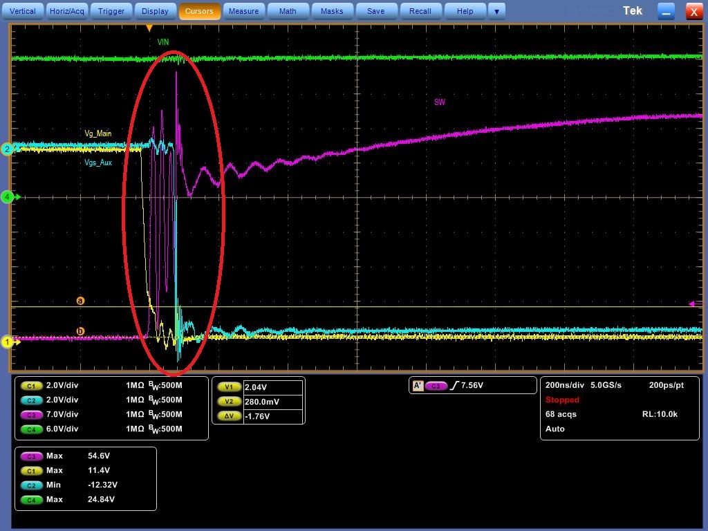

Our customer is using UCC2897A and we have the secondary side phase spike over spec and the spike is reach to 270V(CH2)@1,25A which is too high and over spec (the diode spec is only 200V). please see the waveform as below
And we try to place snubber on PD12 and PD13. the snubbuer on PD13 have no improve on the spike and the one in the PD12 would improve the spike  but it would have a spike pulse shown in the waveform below and also the waveform which RD can't use the solution. Could you kindly give us some suggestions to improve the spike(RD need to push the spike under 180V). we also attach the schematic as below

    Can you capture transformer primary winding current , Main FET Vds and Vds of PD12 in the same waveform when the issue happens?

  • Hi Alec,
    Could you please tell me which point did you captured the Iprimary ?  looks like it's not transformer primary winding current . or the clamping switch is not normally turn on during main switch turn off time. the larger spike on secondary diode was caused by hard switching of main FET.
    Could you please check if clamping switching are normally turn on ?

  • Hi Alec,
    Adjust gate driver resistor value only can speed up/down the turn on slew rate of MOSFET , But what we are talking about are hard switching or ZVS.
    before the main FET turn on , there is must have a negative current through body diode .then the FET can achieve ZVS turn on. you can find it in below image. and compare with the waveform you captured from customer's board . there is no negative current in customer's board .
    so I you have to find out what happens at clamping switching FET.
    In the second image below , point A and point B are different , the current through point A contain both magnetizing and Demag. current .
    but through the current Point B only contain  when main FET turn on.
    I have attached a application note , please forward it to the customer , make sure the customer engineer familiar with some basic knowledge and  debug experience.

  • Hi Alec,
    I have proposed my suggestion in previous two posts : Find out why there is not negative current before main FET turn on , check if the Clamping switch FET didn't turn on after main FET turn off .
    The larger spike was caused by main FET hard switching , because we didn't find the negative current before it turn on in your captured waveform.

  • Hi Johnny,
    I have reviewed your schematic and testing waveform , I have two questions as shown in below:
    1. In the schematic , there is a capacitor PC775 (10nF) parallel on Main FET and current sense resistor. could you please let me know what purpose of this capacitor ?  since it will caused a large discharge current when main FET turn on . and the negative current maybe is not enough for ZVS turn on of main FET due to a lot of energy needed for discharge this capacitor.Can you remove this capacitor and test again?
    2. In the testing waveform . you can find the driver signals for each FET are correct . but when the main FET turn off , primary current reach to peak current.
    then it suddenly drop to below zero and with a large ringing , it should be pass the body diode of clamping switching with a slow slew rate , primary current of XFMR should be a triangle shape rather than the shape presented in your waveform . the only thing I can guess is that if the clamping switch used is a NMOS rather than a PMOS .Could you please help to double check it and check if any disconnection happens ?
    I can see the part number of Clamping switch in the schematic is PA710ED , it's a PMOS , but just carefully check if it's correctly assembled . and you can also capture the current through this FET  to identify if it's correctly turn on during main FET turn off interval.
    BTW: To debug a issue, we need step by step analysis to dig out the root cause rather than a simply component value change try and error.
    Thanks.

  • Hi Johnny,
    It's clear in your test waveform that the clamping switch PQ2 didn't turn on after Main FET turn off . even the body diode didn't conducted during the dead time .
    No current through PQ2 at anytime except for the resonance current (oscillation current shown in your waveform). the current through primary winding should like the yellow line in below waveform, when Main FET turn off at " zone" the magnetizing current should pass the body diode of PQ2 with a slow slew rate even there is no driver signal on Vgs during the dead time . but in your captured waveform , there is a suddenly current drop to negative and very large ringing . that means PQ2 path didn't through the demagnetizing current. as well as main FET path since it already turn off . Lm was resonant with parasitic capacitor , that caused a large spike .  look at B zone , the current should go to below zero to create the ZVS condition for Main FET. but still no current The Vgs of AUX FET is correct .
    If you already check the PQ2 has no problem . the last thing I can guess is the path from transformer terminal to GND has break point .
    Shown as in below image  1 2  3 red line . check your clamping capacitors by the way if it opened
  • Hi Jaden,
    Attached  waveform as we can see the aux FET turn on after main FET turn off.
    But why the negative current not obvious?
    And we also using DVM to check the transformer to GND path. It seems no break point on red line.
    We also confirm the clamping capacitors no open event. The capacitance can measured by DVM.
