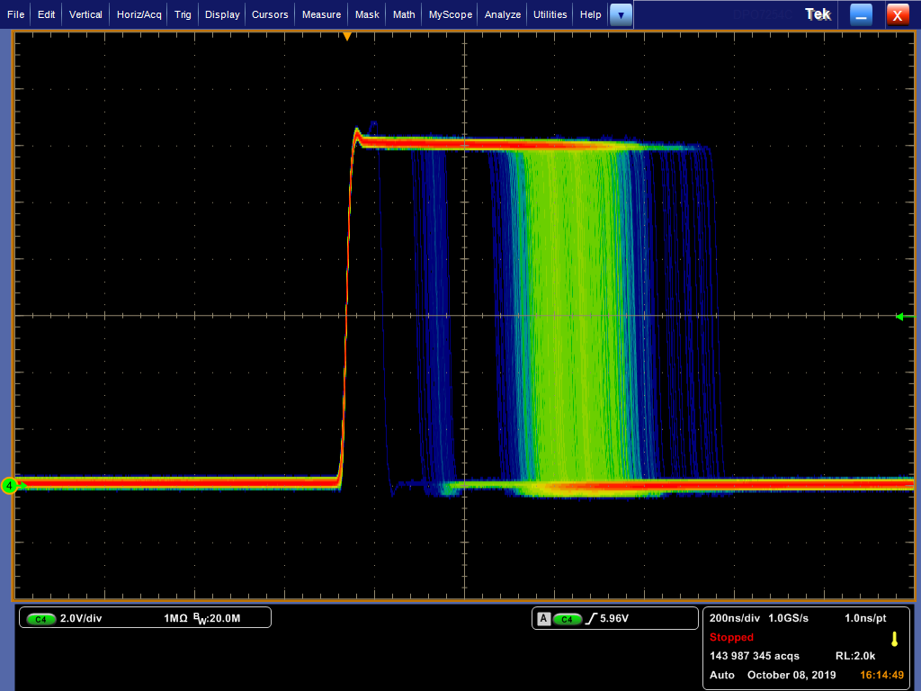

Hi Sir,
Our Customer response the UCD9224 Jitter over 200ns,
Fusion Design Tool can't found out any setting to improve this issue,
Could you please share some suggest for me?
Hugo
Hi Hugo,
Thanks for the update.
Can make Fz lower and Fp higher to see if it helps reduce jitter further.
I'm not sure if we can make jitter less than 40ns. The impact of jitter is output ripple. As long as output ripple meet spec, it should be fine even jitter is larger than 40ns.
