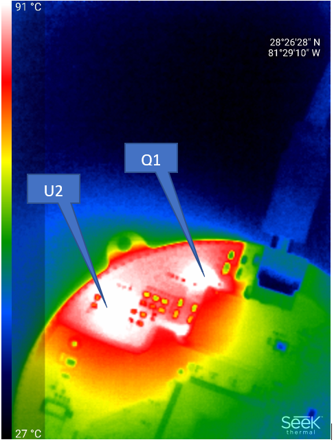

Made some changes to code. Reconnected the power and tried to program it and no connection.
Checked the supply voltage. No supply voltage and all power components are burning to touch.
At this stage, only USB and STM32F7 is active.
Connected the bench supply back, and it looks like Vin and Vout of U2 is shorted.
Checked with Ohm meter between Vin and Vout of U2 and it reads zero ohms.
Connected the supply passed Q1 (bypassing Q1) the same.
Connected the supply passed L2 (bypassing filter) the same.

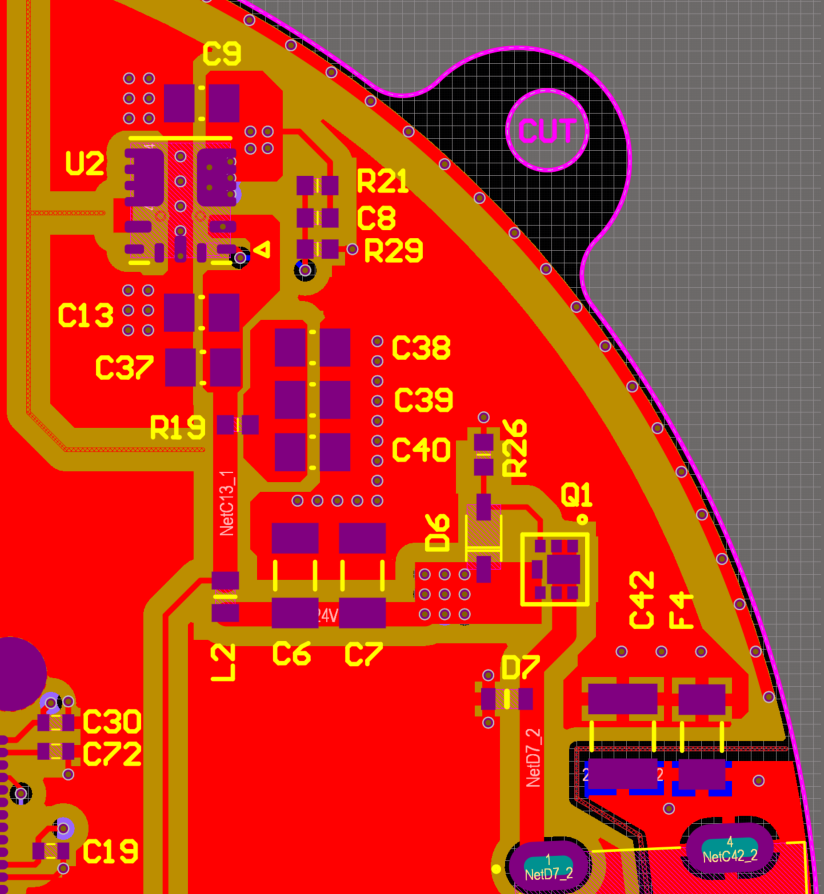

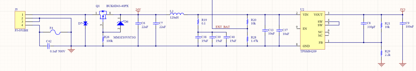

Below is schematic and board layout.

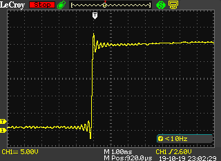

    On a working board, can you please take an oscilloscope capture on the VIN pin 2 of the TPSM84209 when you plug in the 24V supply. Maybe that input filter is resonating when the 24V input is applied and the voltage is exceeding the abs max ratings of the device.

  • No, Since I only have one board and it is dead.
    I am going to go to CM and replace U2. Then I capture voltage on VIN pin 2 of TPSM84209.
    Meanwhile here is a thermal image of the board when I apply 24 Volt power.

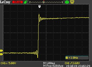

  • I replaced TPSM84209.
    Captured Vin Pin on Startup. It shows an overshoot of 3 volts. I am going to use LMZM23601 for future revisions.
  • I noticed there is also ringing below ground in your Vin waveform. Both TPSM84209 and LMZM23601 allow only down to -0.3V negative voltage on VIN pins in their Absolute Maximum Ratings tables. If the waveform is accurate, the ringing goes to about -3V which may be the cause of damage.
  • Do you have any recommendations about fixing the -3V voltage at startup?
  • Is this the TPSM84209 VIN pin 2 waveform when you plug in your 24V into your power jack? Is the power jack J5? Can you please take another waveform of VIN pin 2 with time x-axis zoomed in more, and also capture the waveform at the 24V net before the filter on a 2nd channel?
    I would like to see the ringing in more detail, and also understand if it is there before the filter as well as after.
