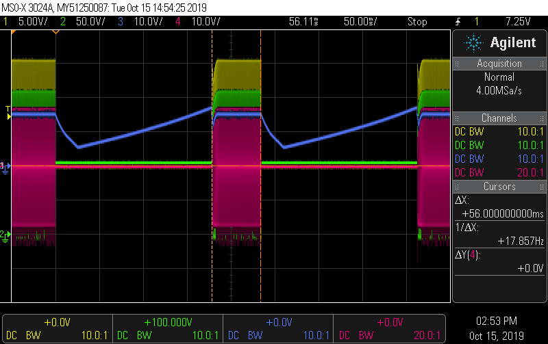

When the input voltage is reduced to below 121VDC, it enters what looks like brown-out detection:
CH1 (yellow): QL gate voltage
CH2 (green): QL drain voltage
CH3 (blue): Vdd
CH4 (pink): Vaux
The switching for 56ms (close to the 60ms brown-out timer) followed by a UVLO cycle leads me to believe this is a genuine brown-out fault.
