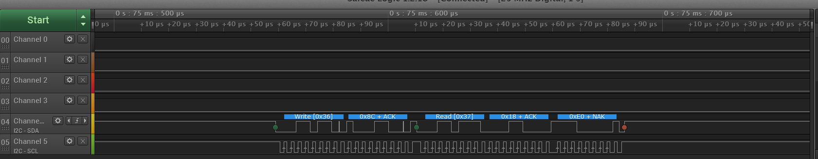

With no load connected I always read 0xE018. The MSB of 0xE0 makes sense but I do not understand why do I read the LSB as 0x18 as you can see from the snapshot below ?
Thanks in advance...

    The TPSM846C23 reports READ_IOUT using the LINEAR11 data format.  The upper 5 bits (15:11) are a 2s compliment value for the exponents and the lower 11 bits are the twos-compliment Mantissa, where the represented value is 2^Exp * Mantissa.
    E0 represents an exponent of -4
    018 represents a mantissa of 24d
    2^-4 * 24 = 24 / 16 = 1.5A
    Read Iout is reporting 1.5A, representing the no load offset of the current sense measurement.  This is consistent with the +/- 3A accuracy specification for the digital current reporting.
