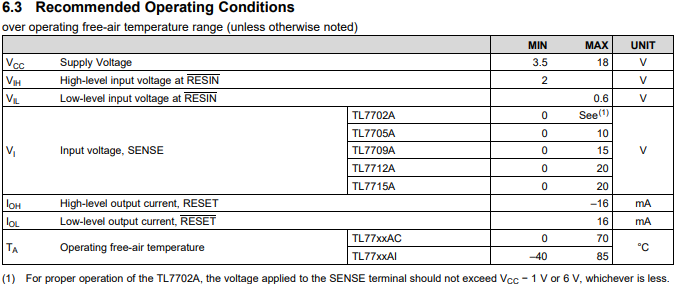

Do we have P2P solution with TL7712A as 12V monitoring to support -40C ~ 85C?

I'm confused at your question, but I think you're asking if this device supports -40 to 85C, which it does, as long as it is the TL7712AI version. This supports 12V (TL7712AI). If you are looking for other specs, please look at our Voltage supervisors (reset ICs) Quick Reference Guide.

I'm not sure why this is not listed in the ordering table at the end of the datasheet. If you look at the section 6.3 Recommended Operating Conditions, you can see that the operating free-air temperature of devices with TL77xxAI part numbers support -40 to 85 C.
Similarly, the table does list -40 to 85 C for other TLxxAI devices, such as the TL7705AIDR. I can look into this offline, but you can show the table above as confidence.
