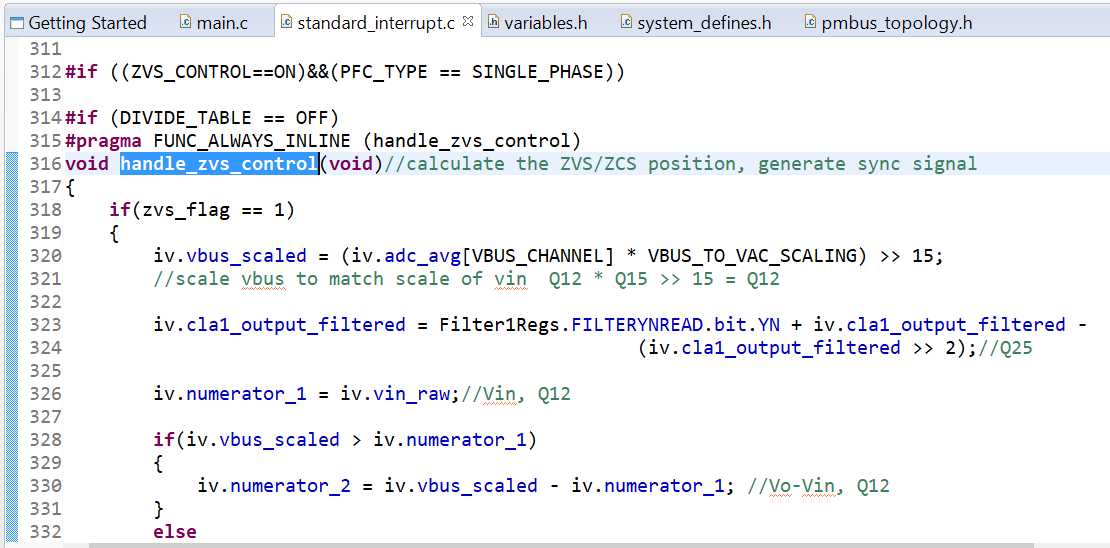

In the standard_interrupt.c ,what do the codes from #314 to 379 mean ?
And why numerator_(1、2、3、4 )are assigned again and again in this way?
Could you please solve my problem?Thanks for your help .

these code is used to do a ZVS control, please see the details in this application note:
http://www.ti.com/lit/an/slua644/slua644.pdf
numerator_(1、2、3、4 )are intermediate variables used in ma thematic calculation, only the final result matters.
