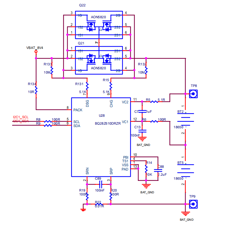

Hi team,
Customer would like to design BQ28Z610 SCH which met "Max charger current=2.5A and Max discharger current=8A"
Could you help me check the below SCH if is ok?
Thanks for your help!
Hi team,
