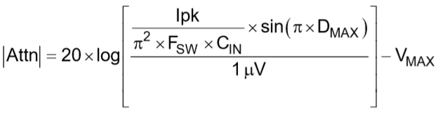

       I read datasheet of LM5141-Q1 , it`s good device for us. For the EMC test I want to know how to derive the formula of EMI filter. could you show me some article or information ?
thank you so much!
following will show the formula from datasheet. page 27.

          I get some documents to understand significance of formula , but something confuse me. could you help me describe following formula :
    Cfb : I think the formula derive from Fc=1/(2*pi*sqrt(LC)) . How to understand |Att|db / 40 ? And why let 10^|Att|db/40 equal to Fc*(2*pi*sqrt(LC)) ? Fc is f_ cutoff.
    Cfa: How to infer this formula?
    Thank you so much!

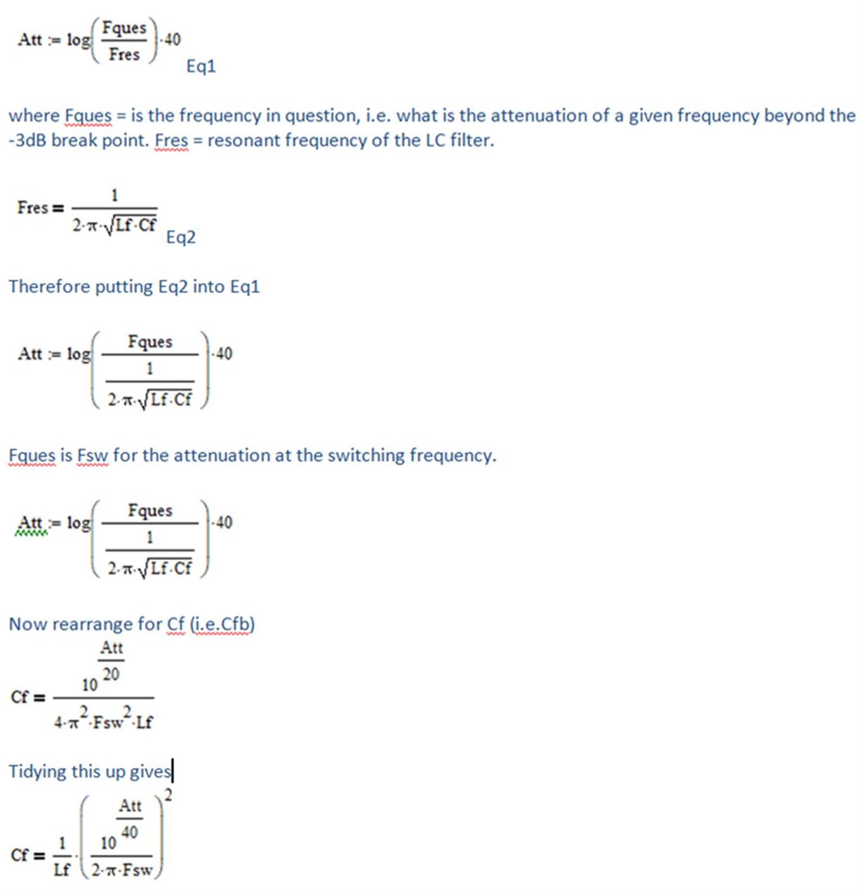

  • The first formula ensures that the resonant frequency of the EMI input filter is at least one decade below the switching frequency. The second formula is derived based on a -40dB attenuation profile of the LC filter.
    Tim
  • thank you Tim !
         could you show me some detailed information , I don`t infer the second formula.
    I think that :
           LC filter have -40db/dec , so if we get |Att|db then we can get : |Att|db - 40db = 20log(Av)-20log(100)=20log(Av/100).  don`t infer the 10^|Att|db/40.
    Thank you so much!
  • Here is the derivation:
