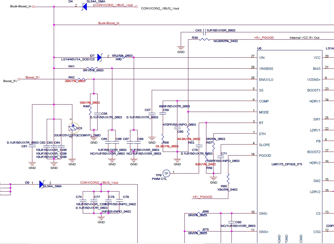

Dear Sir/Ms.
My customers report that they designed the LM5175 to have a high-frequency sound when it was loaded at 3A.  When the customer found that more than 0.8A was loaded, Vout would fall. It should be top to protect.
The customer's specifications are as follows.
Vin= 5V
Vout=8.7V
Iout =  3A

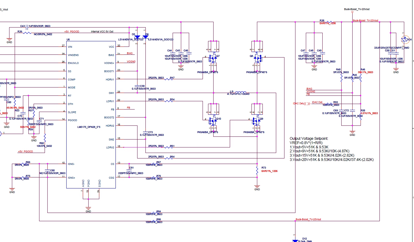

schematic

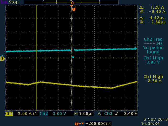

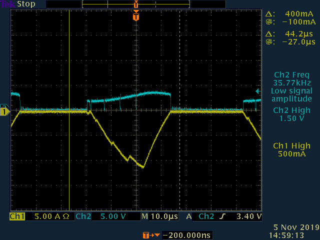

0A Load Wave form , Ch2 = Pin15 (L9 ,Q8, Q9), Ch1= Indicator current (L9)

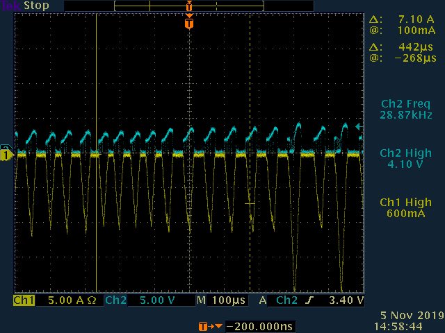

3A (Electronic DC Loader)
would you please give us some advice?
