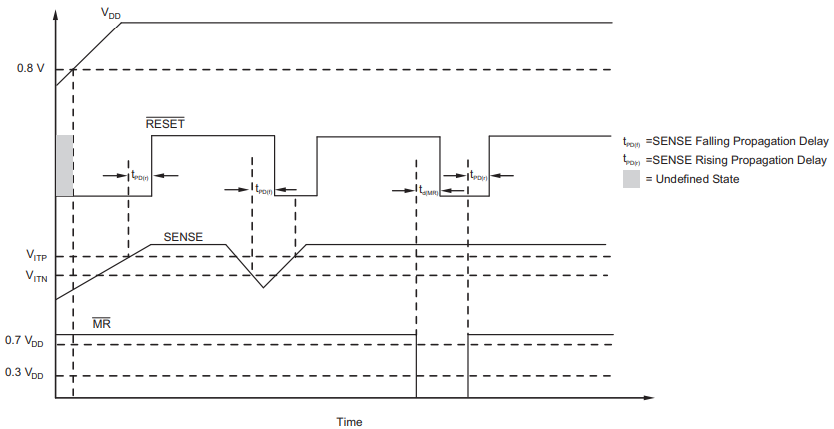

  • Hi Malli,
    I will try to better explain the conditions using this timing diagram from the datasheet:
    The way the interaction with MR and RESET works is shown here. When the device is in a good state on SENSE (healthy rail, not below threshold) AND MR is logic high, RESET will be logic high (not in reset). When MR is pulled low, RESET will go logic low after td(MR). This signal will then come back up to logic high after MR is pulled high after tPD(r). Use this to design your ASIC accordingly.
    For question 4, if you tie SENSE to 3.3 V, you must also design the VITP and VITN such that the VITN is 3.17 V using the correct resistors, and then the device will behave like TPS389033. If this is the case, however, just use that specific device.
