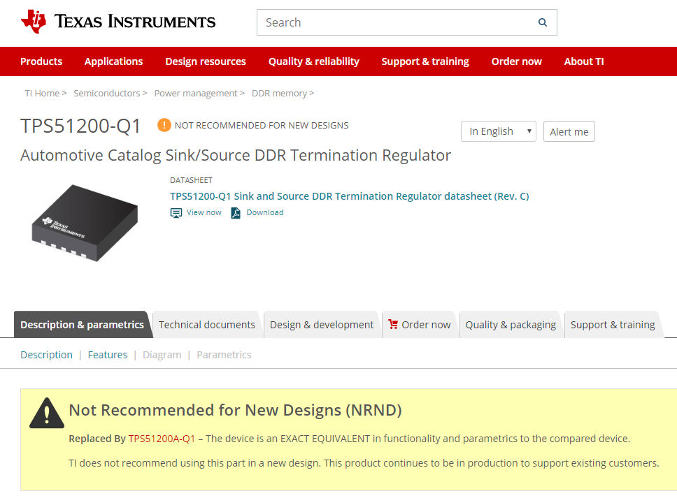

Could you please tell me the difference between TPS51200-Q1 and TPS51200A-Q1 in detail ?
I understand that TPS51200-Q1 isn't recommended for new designs.

Kato-san,
I think the polyimide layer will improve reliability.
Qian
Kato-san,
There should be no concern to continue using TPS51200-Q1.
Qian
Kato-san,
As TPS51200A-Q1 is available, we recommend customer to use this part for new project.
If TPS51200-Q1 is already used in the production, it should be fine to continue use this part. TI will supply the part as long as customer has requirement.

I would like to confirm just in case, so is TPS51200A-Q1 improved not only reliability but also electrical characteristics if comparing TPS51200-Q1 with TPS51200A-Q1 ?
Kato
Kato-san,
there is no difference in electrical characteristics between TPS51200-Q1 with TPS51200A-Q1.
Qian
Kato-san,
Some automotive customers want to add polyimide layer to improve reliability further.
