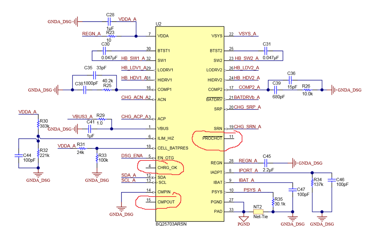

Hello.
I'm designing module with BQ25703A charger. I'm planning to use only I2C to communicate with it. I read datasheet, but in my case what to do with some pins is not clear to me.
According to EVM CHRG_OK, PROCHOT, CMPOUT have pull up to +3V3. But I don't have 3V3 source on board. So:
1. CHRG_OK pin. Datasheet says “connect to the pullup rail”. If I don’t use it, can I leave  CHRG_OK floating? Can I still get its correct status via I2C ChargerStatusRegister, AC_STAT bit?
2. PROCHOT pin. If I don’t use it, can I leave CHRG_OK floating?
3. CMPIN and CMPOUT. I don’t use it. I grounded CMPIN. Can I leave CMPOUT floating?
4. EN_OTG pin. To have control over OTG mode via I2C can I pull this pin to VDDA (REGN)? Or it doesn’t work and I cannot control OTG without pulling this pin to +3V3 source?
5. Also CHRG_OK is active high. So if I pull it up, for example as in EVM, without connected adapter, will it constantly draw current through 10kOhm from +3V3, that powered from battery?..
