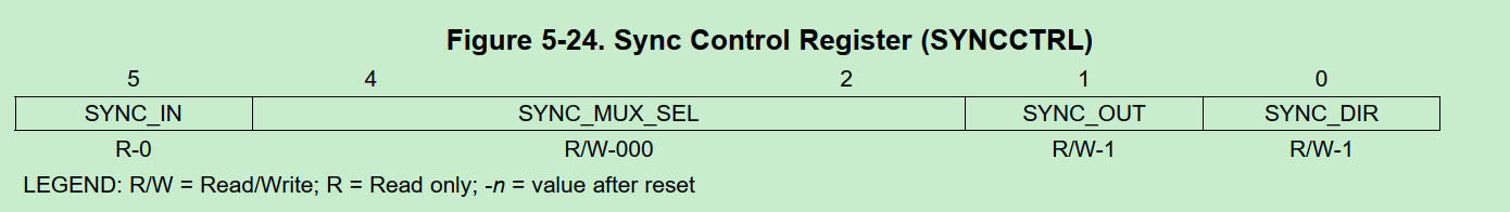

    About the sync signal you said,I have just looked at the specification.Do you mean this register?
    Can I understand this: When there is a transition signal from low level to high level on the sync pin, UCD3138 stop the DPWM period and restart it from the beginning ? So I can connect the external zero current detection signal directly to the sync pin?

  • That register you can just leave in its default state.  The SYNC pin default is an input, and you want to leave it that way.  the key bit is the EXT_SYNC_EN bit in DPWMCTRL1 in the DPWM registers.  If you set that bit for a specific DPWM, that DPWM will have its counter rest and restarted by a rising edge on the SYNC pin.
    When you say the on-time should be determined by the filter, you really mean the off time from the start of the filter to the turn on time, right?  The edge which is controlled by the filter is the falling edge of DPWMxA.   and the rising edge of DPWMxB.  So I guess you could use DPWMxB for your signal.  The secret to doing this is to set EVENT4 to 0.  That way DPWMxB will be turned off as soon as the DPWM is reset by the sync signal.
    I should mention that you need to ignore all the other things that say sync in the DPWMCTRL registers they are for sync between DPWMs, not external sync.  And for SYNC FETs, not external sync.
