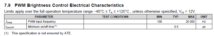

High dimming ratio at 100 Hz is 10 000:1 in datasheet.
Dimming ratio @ 100Hz= (1/100Hz)/0.5us=20 000: 1 at 100 Hz, but the discreption of dimming ratio in datasheet is 10 000:1 at 100 Hz.
Is my calculation method wrong? Why?
