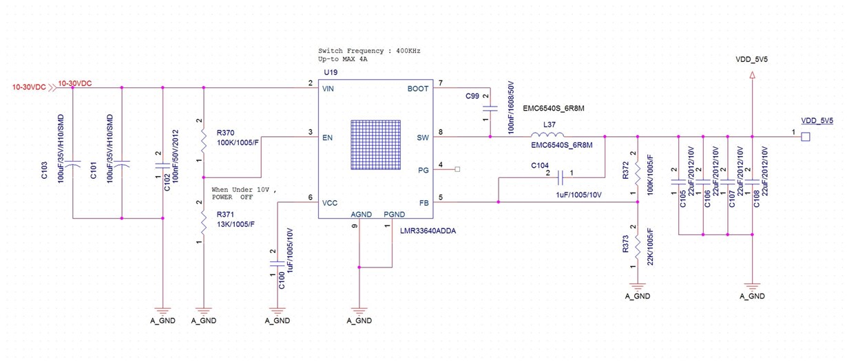

Hello
I Request a Design Review for Follow Condition.
Input Voltage : 24V(Min 10V ~ Max 30V)
Output Voltage : 5.5V
Output Current : 3.5A
Would you tell me advice the this design?
Best Regards.
Hello
Best Regards.
C104 is too large. See 9.2.2.8 to design a reasonable value.
