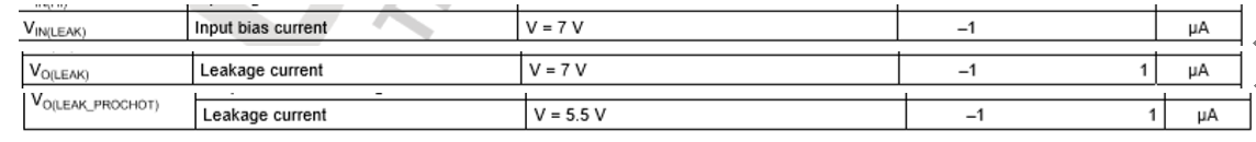

6.The meaning of V=7V in the figure below.(p10)

    For 6) This is the leakage current when that voltage is applied to those pins individually.
        Why is the voltage 7v when his operating voltage is 6.5v,just the test conditions?

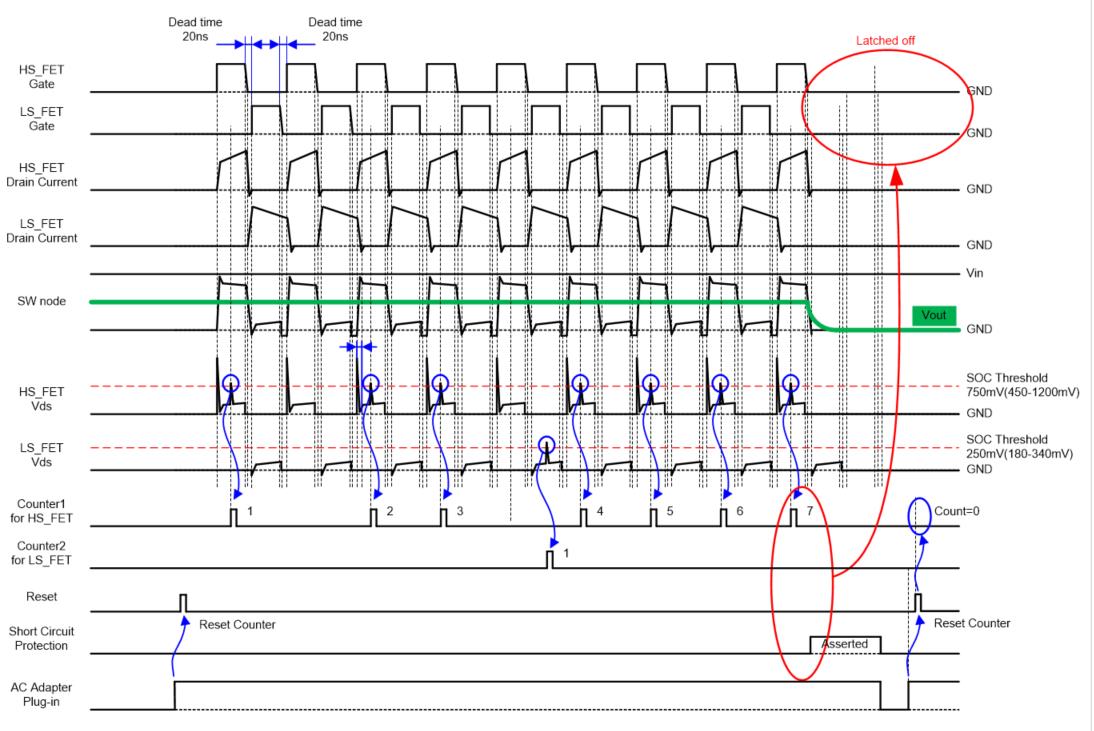

    8.Some questions about inductor short,MOSFET short protection.
      8.1  What's the difference between inductor short and MOSFET short protection?
      8.2  Is protection triggered only if both high mos and low mos are above the threshold?
      8.3  After seven short circuit events, the charger is latched off. Why not trigger it the first time?
      8.4  During boost function, the low-side MOSFET short circuit protection threshold is used for cycle-by-cycle current limiting, charger does not latch up. How to understand?

    For 6) This test condition is based on the absolute maximum voltage rating of these pins, not the recommended operating voltage.

    For 8.1-2) Please see the following diagram:
    For 8.3) This could be a sudden spike in current, and does not necessarily assume converter is continually providing more than the peak current. In general, MOSFETs can handle pulse current at currents much higher than their continuous current rating.
    For 8.4) In buck mode, after 7 occurrences of this event in 90sec, the ACFET/RBFET will  be latched off. However, in boost mode, this will not latch off the input FETs. Boost mode on this charger is purely supplemental current to the load.
