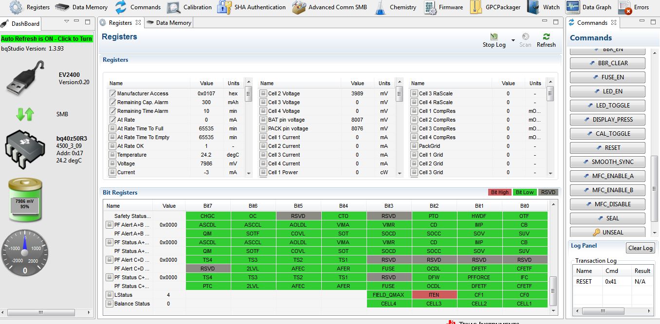

Hello TI,
I had completed first set of learning cycle on ICR18650-2500 mAh, 2s-2p configuration,got successful learning cycle.
But,now we started second set of cycle on INR18650-2000 mAh,2s-2p configuration but we was failing in QMAX updates and also in the L status didn't changed to 5.
we are in the second relax mode,According to a slu777 manual, problem is QMAX bit not setting,L status also not change to 5.But RESET register bit is going set after completing the relax mode.please Resolve my issue.thanks in Advance.i Attached a screenshot for your Reference.
