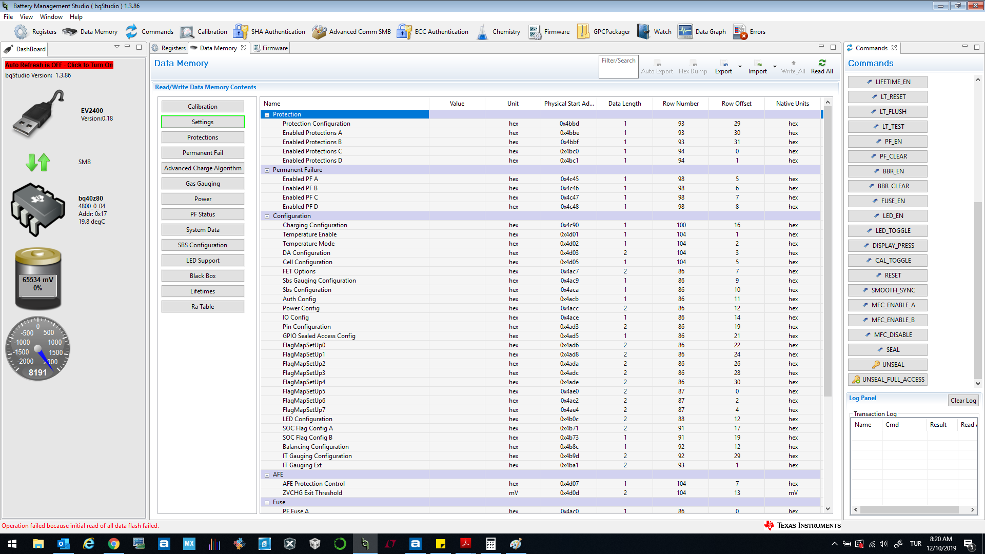

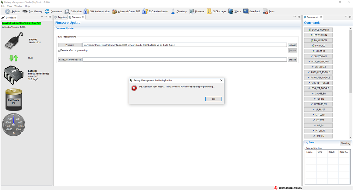

Hello;
We have encountered such an error in 2 of the IC. Why does this happen? In this case a new image can not be discarded.
1- Why does this happen?
2- How to solve?

But unseal full access does not work. I do not communicate in any way with the device.

Please attach a screenshot of the data memory window (data class doesn't matter).
Did bqStudio recognize the gauge or did you manually select it from the list when you launched bqStudio.
What interface do you use (EV2300, EV2400, GDK)?
Please use the latest bqStudio 1.3.92 and also upgrade the EV2400 FW by searching for EV2400 on ti.com. It will take you to the FW updater.
