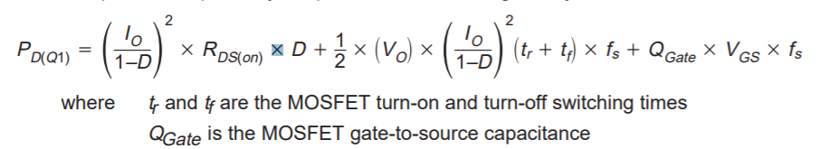

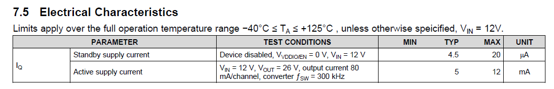

Is my calculation is right?
P=P1+P2+P3
P1=VIN*12mA
P2=Pmos_internal=
P3=Iout_1*Vout_1+Iout_2*Vout_2+Iout_3*Vout_3+Iout_4*Vout_4
The bigest problem is how to indentify the Vout_x?
May you have any other suggestion?
