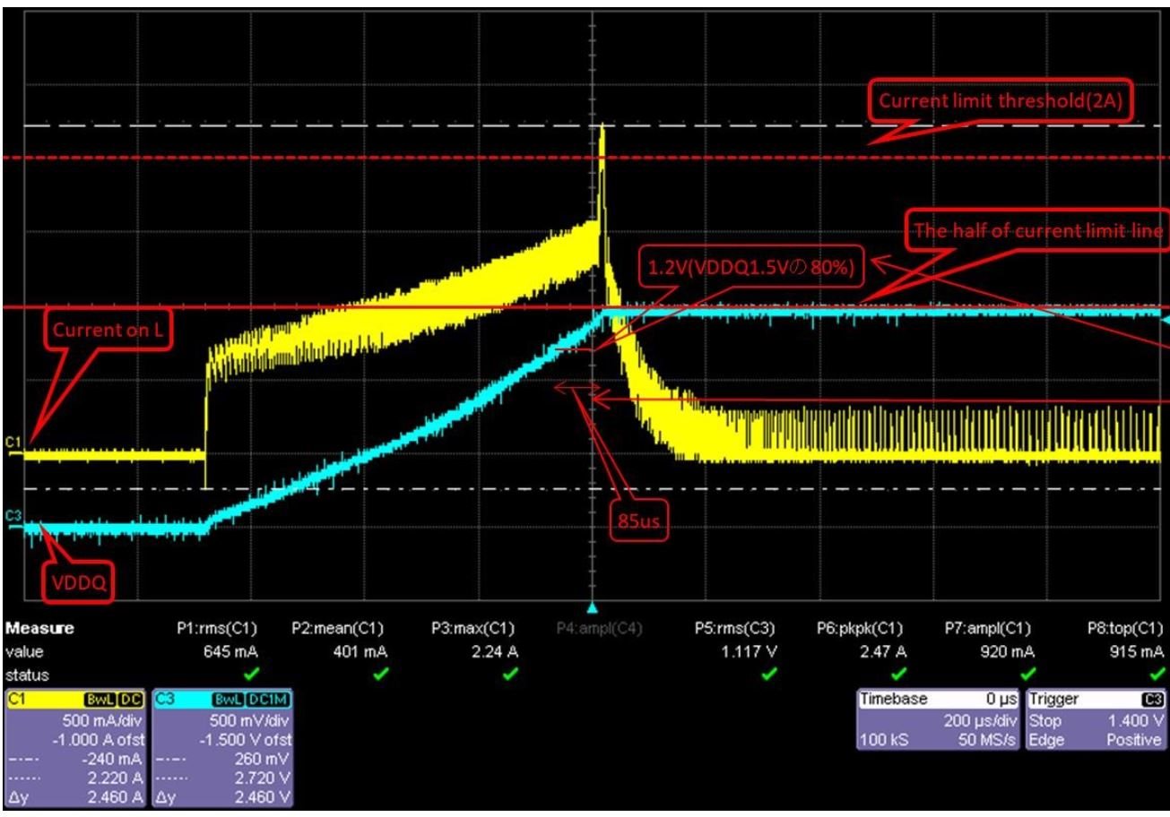

Hi, Team.
could you tell me why does IC set the over current as half of nominal value ?
> 8.3.9 Soft-Start Function and Powergood Status The soft-start function
> of the SMPS is achieved by ramping up reference voltage and two-stage
> current clamp. At the starting point, the reference voltage is set to
> 650 mV (87% of its target value) and the overcurrent threshold is set
> half of the nominal value. When UVP comparator detects VDDQ become
> greater than 80% of the target, the reference voltage is raised toward
> 750 mV using internal 4-bit DAC. This takes approximately 85 μs. The
> overcurrent threshold is released to nominal value at the end of this period.
