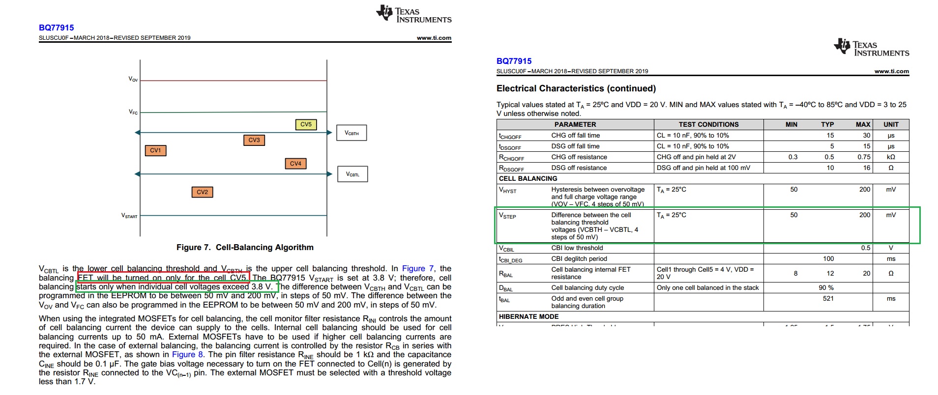

I'm not expert and probably is my fault; but in my opinion the DS is a bit poor regarding this feature; it's a bit short and seems that some data is missing.
Attach you can see a picture with two page from the BQ77915's DS.

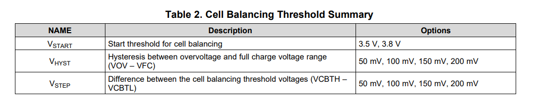

I assume that to trigger the internal FET balancing is required (besides no alerts and charging mode):
1) Some CV greather 3,8V.
2) Some CV greather that VCBTH.
But the 2) implies by itselt the 1), it isn't? Or maybe not; because the DS show the DIFERENTIAL VALUE, I mean (VCBTH-VCBTL) but doesn't speak about the ABSOLUTE values of this limits.
So the difference (VCBTH-VCBTL) can be programmed via EEPROM, 50mV,100mV,150mV and 200mV. OK, but:
- WHERE THE ABSOLUTE VALUE  OF THEM, ARE EXPLAINED?
- Regarding the picture,  I assume that, if the CV5 is reduce to a value between VCBTH and VCBTL the cell balance continues. If continues reducing below VCBTL, then stop the cell balancing. I'm right?
- The VCBTH-VCBTL seems to be programmed into the buit-in EEPROM. Can I access to the EEPROM? I think not because there is not a I2C channel. Then I have to access to my Local representative to order a device with my desired VCBTH-VCBTL step? The  "Device Comparison Table" (page 3) show 4 variants BQ7791500..04, but what happen if I need other values?

    The cell balancing algorithm of the device is quite complex, here is a video we made that should help clear things up:
    https://training.ti.com/how-cell-balancing-feature-works-bq77915
    The cell voltage at which the cells begin to balance is configurable by the TI factory. It can be either 3.5V or 3.8V. Check the device configuration table for each device's configuration.
    Once that requirement has been met, the device will evaluate the cell voltage values and balance accordingly. This behavior is described in the video, but let me know if anything is still unclear.
    These values are all determined by the EEPROM which is configured by the TI factory. There is no way for the user to access these values. We cannot configure these values to be something other than what is described in Table 2 of the datasheet.
    Please let me know if you have any additional questions!

    According to Table 2, seems that there are a lot devices available.
    But according to Device Comparison Table, regarding the VStart, Vhyst and Vsetp, only two options available: BQ7791500,01,02 (3.8V 100mV 100mV)      or     BQ7791504 (3.5V 50mV 50mV)
    I'm right?
  • Hi Albert,
    We only create new configurations of the device when there is a specific request and a business need. Table 2 shows the capabilities of a new device. The BQ77915 is our most recent battery protector, so we are still building our portfolio. Continue to check the device comparison table to see the newest releases.
