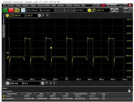

Do we have the specific working frequency range of TPS65094A BUCK? Our customer test the SW node of BUCK 6, the frequency is up to 2.77MHz, and they have the concern that this may cause some problem to the IC and they'd like to know the exact range frequency range of TPS65094A BUCK. Could you please give some comments on that?

  • Hi Livia,
    Is an ATX power supply being used to power the PMIC? Is VSYS being supplied with 12V in this case? This is a higher switching frequency than I would expect in that case but powering VSYS with 12V and the buck controllers with 5V has an impact on switching freqeuncy. What is the switching frequency of the other bucks?

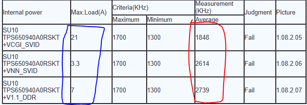

  • Hi Layne,
    VSYS is powered with 12V and buck controller is 5V in customer's use. For the requency of other bucks, please refer to the table below.
    Do we have the frequency limit range of the bucks? And will this large frequency cause any issue to the IC itself?

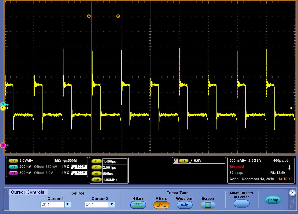

  • Hi Livia,
    I tested the EVM using a 5V supply for the controllers and a 12V supply for VSYS and the highest switching frequency I saw was around 2 MHz. It seems like applying a load caused a shift in the frequency from 1.7 MHz at no load to around 2 MHz at a 7 amp load on buck 6. I included a screenshot of this below.
    When your customer is measuring their switching frequency is it at a high load? Can you provide me a schematic for further review?
    Layne J
  • Hi Layne,
    Please refer to the table below for test frequency and load condition.
