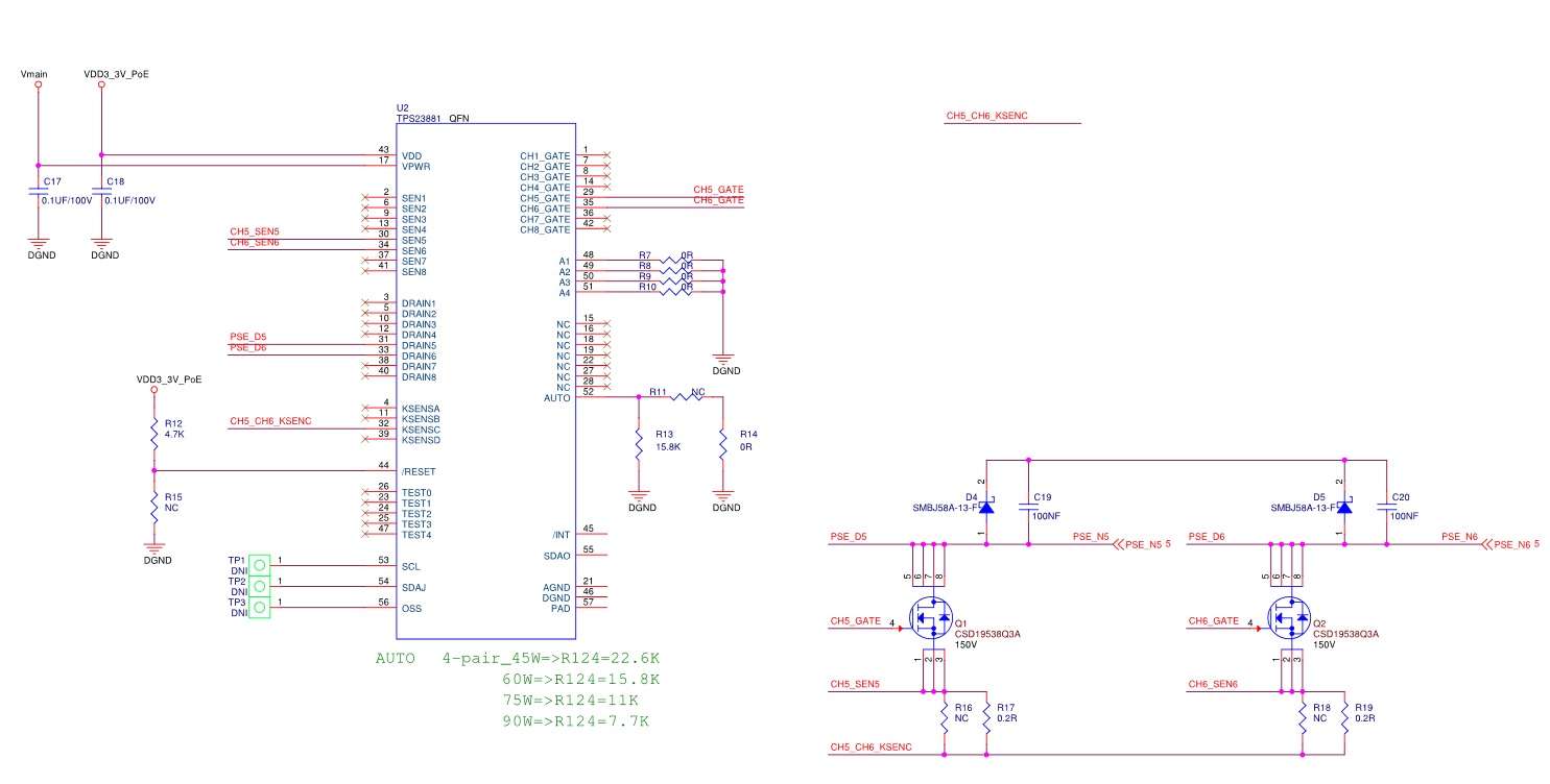

Attach BT POE injector circuit. Please assist review it.(Please see the below)
Thanks!

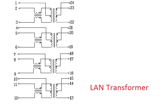

  •  LAN transformer pin define below.

    Sorry, Maybe I didn't describe it clearly.
    I want design one port PSE injector product.(only one RJ45 port provide POE 60W output)
    Please see the application drawing below.
    I already reference for "TPS23881EVM-008"+"BOOST-PSEMTHR" EVB circuit.
    ould you assist verify POE circuit(please see last post)?
    Please especially focus IC (U2)peripheral circuits and connecting LAN transformer(T2) pin traces.
    Please assist. Thanks!

  • Hi Caspar,
    The schematic looks good overall, but please follow the datasheet for unused port connection. If you want to add test point for I2C bus, you will also add the test point at SDAO.
    For the data transformer, please make sure it can handle the current level you need.

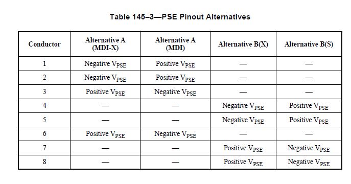

    If you would run type 4, 90W, please make sure the polarity meets IEEE standard below.
    Penny

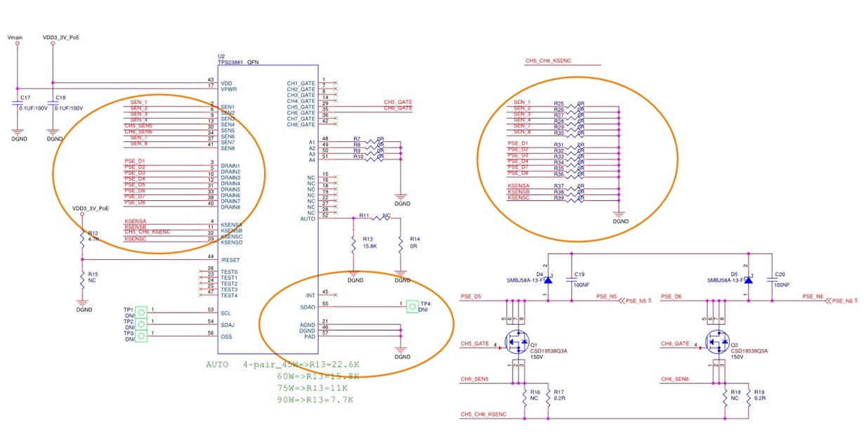

    I already modify some circuit. Please see the below.
    Modify list
    1. unused port "SENx" and "DRAINx" pin connect to ground
    2. Pin 21/46/57 connect to ground
    If the circuit have any wrong. please let me know.
    Thanks!
    Caspar
  • Hi Caspar,
    Please make sure you do the following check:
    1. Change the  LM5574  to LM5019 and set UVLO to ~30V
    2. Please make sure the data transformer can handle the current level you need
    3. If you would run type 4, 90W, please make sure the polarity meets IEEE standard.
    Other than these, everything looks OK. Thanks.
