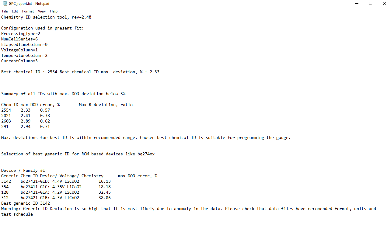

I updated chemistry programming on Ti. Latest chemistry version : 747. But best chemical ID = 2554 which came from GPC_report.txt is a missing chem ID.
Following picture is about GPC_report.txt
