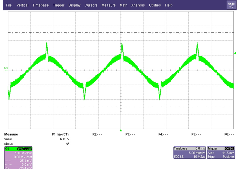

    If RSENSE is set too high you will get a current waveform that looks like this :
    John

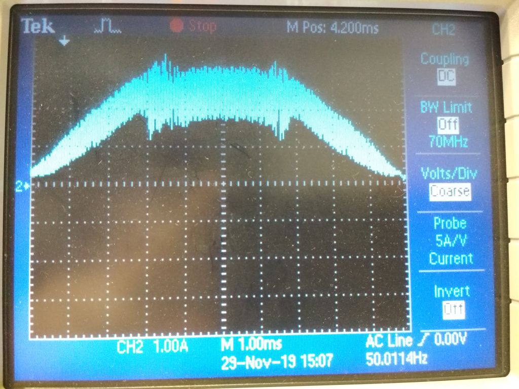

    I attach some pictures, sorry for the quality but I only had phone photos of the scope screen.
    First, there is a far view of the inductor current when the problem occours.
    Current peak is ~3A.

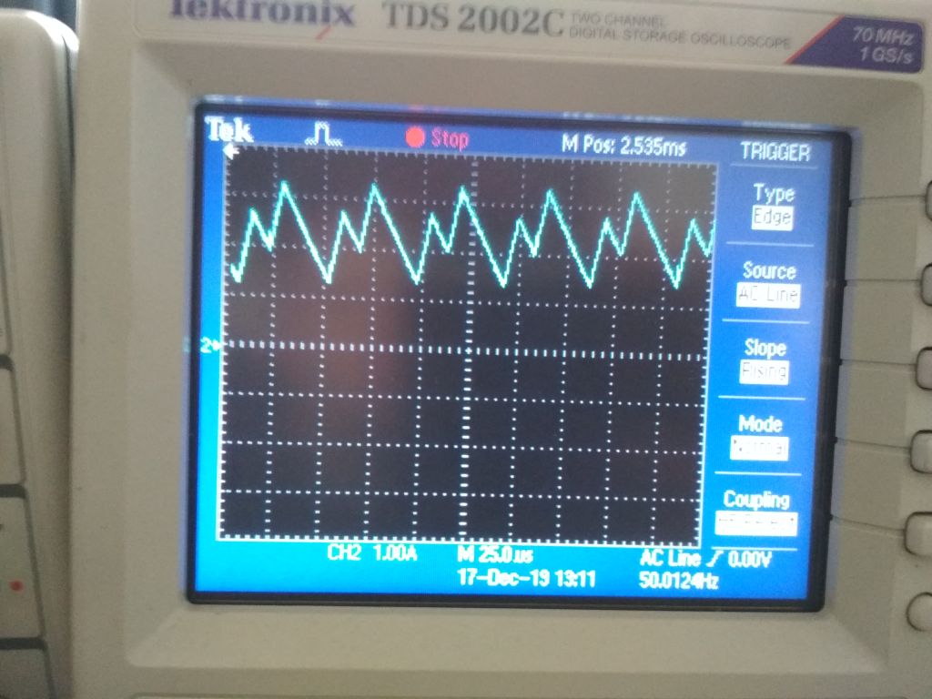

    And the switching is like this at the top (not made on the same day but in the same situation):

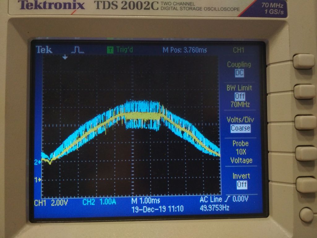

    And now after take the ICOMP voltage saturation account I made a measurement on pin 2 (ICOMP) with the 0.11 ohm Rsense which is still too high but the inconsistent current waveform has a narrower width. It seems that that amplifier really saturates at 5V. Then the datasheet is bad when states 6.4V ICOMP for Dmin. So is this mean that we can't protect our circuit for overcurrent if we want higher power than 350W (design example)? Datasheet states >2kW power with this IC.
    Gyula
